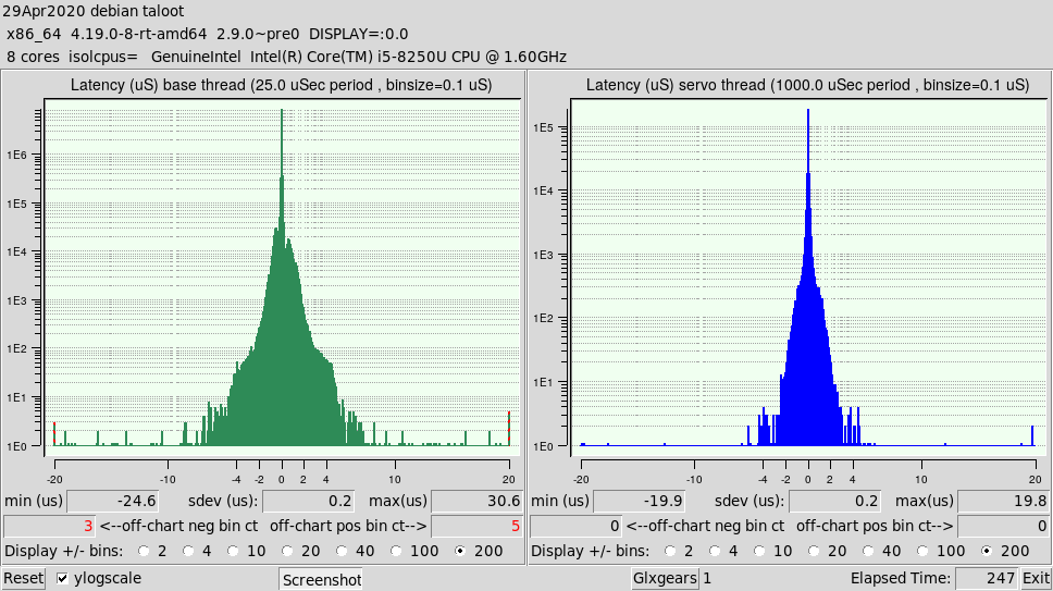

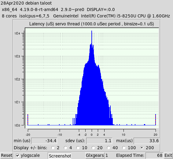

i have this laptop and i will use it as cnc controller.
its fast,, and i will use mesa via ethernet,, but i have some red number in the latency histogram, letency about 30 usec.. but im worry about the red numbers, off chart bin ct
is it safe to use this laptop? with mesa ethernet

28 Apr 2020 19:00 #166038
Replied by tommylight on topic i5-8250U laptop for Linuxcnc with ethernet
Open terminal, type:
latency-histogram --nobase
Get us a screenshot.

28 Apr 2020 19:48 #166041
That looks very promising.
While doing that latency test, open more glxgears, like 5 or 10 and maximise and minimise one of the glxgears screens, play a HD youtube video and also maximise and minimise it, copy some files from one folder to another. Do that for at least 15 to 30 minutes and leave the test going for at least an hour.
If the numbers do not jump much, it should be OK.
Do you have a Mesa ethernet board ?

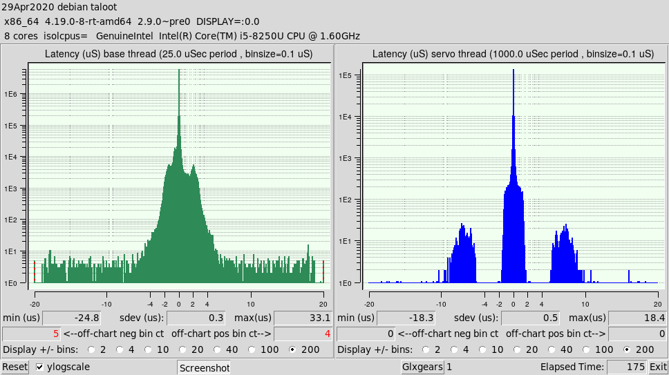

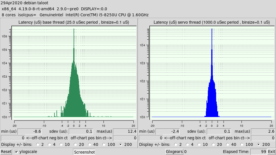

29 Apr 2020 11:42 #166099
by taloot
its about 15 us now
yes i have mesa ethernet board
Replied by taloot on topic i5-8250U laptop for Linuxcnc with ethernet
its about 15 us now

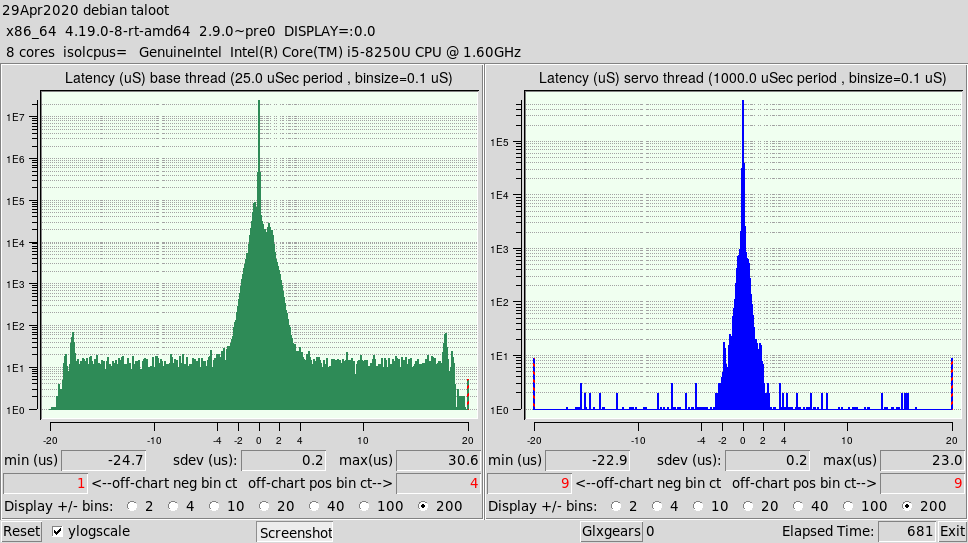

29 Apr 2020 11:45 #166100
by taloot
i want hyperthreading ,, i will use external motion controller,,, so i assume no need to isolcpus, but i was testing,,,
the most effective tweak,, was set fixed cpu speed + performance governor
if i have low latency + externel motion controller, do i benfit?
Just make sure that the cores you isolate share the same cache. And disable hyperthreading which appears you have enabled.

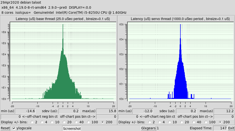

29 Apr 2020 12:22 - 29 Apr 2020 12:29 #166111
by taloot
i agre with u if i use LPT... but with external motion controller,,, i think my current results is so good and enought,,,
no more gain i will get if i disable the HT
also my client using very large decorative gcode,, i want fast machine
with isolcpus,, i decide where the money goes,, to intel or to mesa,
