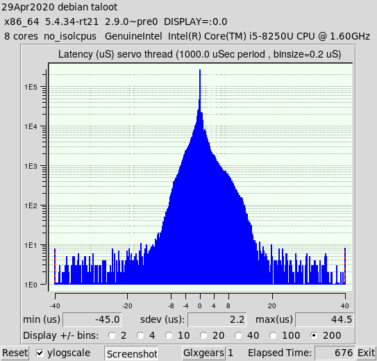

Note that as long as you can reliably meet the 1 ms servo thread deadline
with a few 100 usec to spare, there is no advantage to futzing around to get
the minimum latency as it simply does not matter (at least with most hardware interfaces)

Replied by tommylight on topic i5-8250U laptop for Linuxcnc with ethernet
That looks very good, but only one glxgears and 10 minutes time.
Leave it for an hour at least 10 glxgears, play youtube videos, copy some files around.....

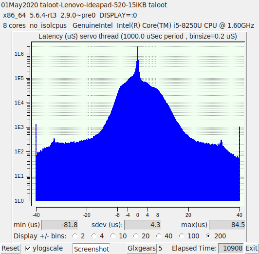

i retweak the kernel,, and running the test again with 10glxgear

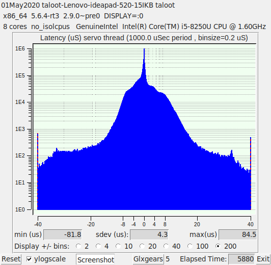

01 May 2020 11:11 - 01 May 2020 11:12 #166337
by taloot
Replied by taloot on topic i5-8250U laptop for Linuxcnc with ethernet
Last edit: 01 May 2020 11:12 by taloot.

That should be fine for a 1 KHz servo thread. You can also get some idea of the network
stack latency by pinging the Ethernet card and checking the min and max ping times.
The first ping will likely be longer since the host needs to acquire the remote cards
MAC address via an ARP transaction.
