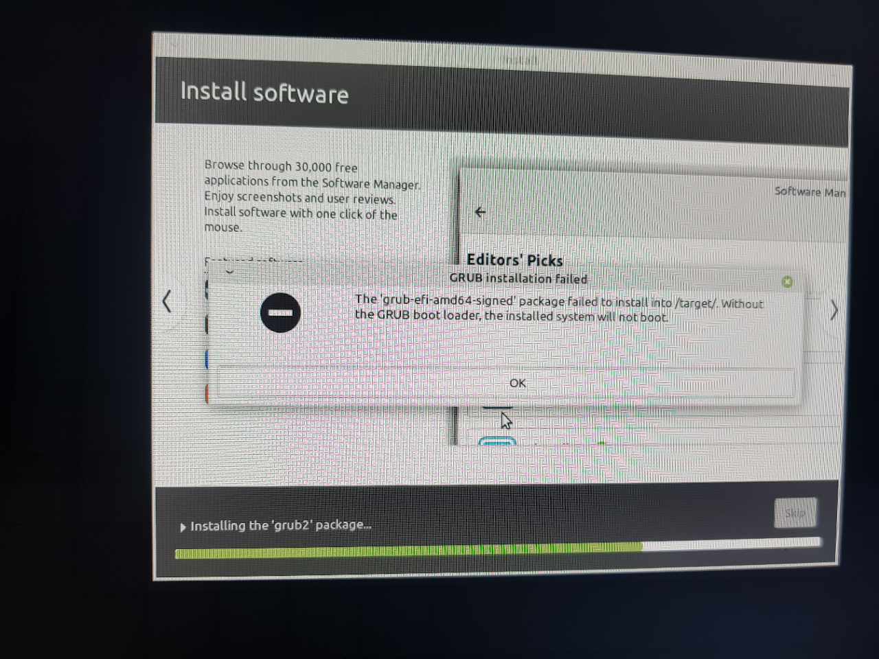

I am trying to install linuxcnc on my new Odroid H2+.
I have downloaded the iso from
cnc.beaglebrainz.net/cdimage/cnc-19.3.0-...lus-uspace-64bit.iso
However, when I try to install, I get the attached error.
Any ideas what is causing it?

Can you reboot and check this first:Then check that you have a network connection.
mount | grep efilsmod
Last edit: 02 Oct 2020 05:30 by BeagleBrainz.

Sorry, I'm new to linux, I'm going to need a bit more explanation.
I didn't have a network connection. Is a network connection required for install?

Replied by BeagleBrainz on topic Mint 19.3 Linuxcnc Odroid H2+
Yep.
I just booted from the same image and on my end everything is fine.
Once you connect to a network and have an internet connection the install will go ok. Best option is a network cable.
This has nothing to do with me at my end, but is just part of the original Mint installer.

I'll hook up the Ethernet and try again
