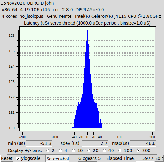

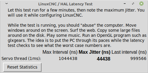

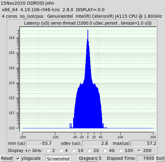

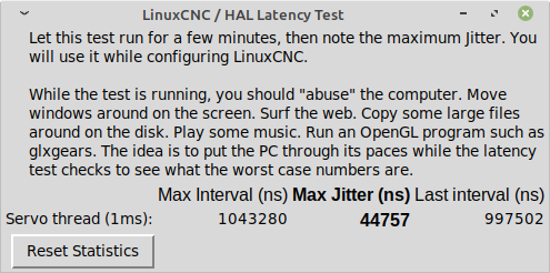

15 Nov 2020 16:36 - 15 Nov 2020 17:50 #189483
by JohnnyCNC
Replied by JohnnyCNC on topic Mint 19.3 Linuxcnc Odroid H2+
Here are my results with a ODROID H2+ with a 250 GB Samsung 970EVO Plus NVNe M.2 and 2 x 4GB Samsung K07G00003216C299EB SO-DIMMs. I used the ISO that BeagleBrains built (Thanks Rob)
This was after an hour of running. I ran this after the above had run for 2:11.
I will post all of my bios setting later.
I also found it odd that when I ran the script to test latency I got far worse results. I am going to try that one more time without changing anything.
Edit to add BIOS setting used in test.
>Main
>Advanced
>ACPI Settings
ACPI Sleep State = [Suspend Disabled]
>Smart Settings
SMART Self Test = [Disabled]
>Serial Port Consol Redirection
Com0
Consol Redirection = [Disabled]
>Consol Redirection Settings
Com1
>Legacy Console Redirection Settings
Redirection COM Port = [COM0]
Resolution = [80x24]
Redirect After Post = [Always Enable]
Serial Port for Out-of-Band Management/
Windows Emergency Management Service (EMS)
>CPU Configuration
>CPU Power Management
EIST = [Enabled]
Turbo Mode = [Enabled]
Boot performance mode = [Max Performance]
Active Processor Cores = [Enabled]
Core 0 = [Enabled]
Core 1 = [Enabled]
Core 2 = [Enabled]
Core 3 = [Enabled]
Intel Virtualization Technology = [Disabled]
VT-d = [Disabled]
>SIO Configuration
>[*Active*] Serial Port 1
>[*Active*] Serial Port 2
>Network Stack Configuration
Network Stack = [Enabled]
Ipv4 PXE = Support = [Enabled]
Ipv4 HTTP Support = [Disabled]
Ipv6 PXE = Support = [Enabled]
Ipv6 HTTP Support = [Disabled]
PXE boot wait time = 0
Media detect count = 2
>NVMe Configuration
> Samsung SSD 970 EVO Plus 250GB
>USB Configuration
>Realtek PCIe 2.5GBE Family Controller
>Thermal
>Chipset
>North Bridge
Max TOLUD = [2GB]
>South Bridge
OS Selection = [Intel Linux]
>Uncore Configuration
GTT Size = [8MB]
Aperture Size = [256MB]
DVMT Pre-Allocated = [64M]
DVMT Total Gfx Mem = [256M]
Cd Clock Frequency = [316.8 MHz]
GT PM Support = [Enable]
PAVP Enable = [Enable]
ASMF = [Disable]
>South Cluster Configuration
>HD-Audio Configuration
HD-Audio Spport = [Disable]
HD-Audio DSP = [Disable]
HD-Audio CSME Memory Transfers = [VCO]
HD-Audio Host Memory Transfers = [VCO]
HD-Audio I/O Buffer Ownership Sele = [HD-Audio Link owns ...]
HD-Audio Clock Gating = [Disable]
HD-Audio Power Gating = [Disable]
HD-Audio PME = [Disable]
HD-Audio Link Frequency = [24 MHz]
iDisplay Link Frequency = [96 MHz]
>LPSS Configuration
LPSS I2C #6 Support (D23:F1) = [PCI Mode]
Set LPSS I2C #6 Speed = [400KHz]
LPSS I2C #7 Support (D23:F1) = [PCI Mode]
Set LPSS I2C #7 Speed = [400KHz]
>PCI Express Configuration
PCI Express Clock Gating = [Enabled]
PCIE Port assignment to LAN = 1,2
Port8xh Decode = [Disabled]
Peer Memory Write = [Enabled]
Compliance Mode = [Enabled]
> PCI Express Root Port 1
ASPM = [Disabled]
L1 Substates = [L1.1 & L1.2]
ACS = [Enabled]
URR = [Disable]
FER = [Disable]
NFER= [Disable]
CER = [Disable]
CTO = [Disabled]
SEFE = [Disable]
SENFE = [Disable]
SECE = [Disabled]
PME SCI = [Enable]
Hot Plug = [Disable]
PCIe Speed = [Auto]
Transmitter Half Swing = [Disable]
Extra Bus Reserved = 0
Reserved Memory = 10
Reserved I/O = 4
PCH PCIe LTR Configuration
PCH PCIE LTR = [Enabled]
Snoop Latency Override = [Auto]
Non Snoop Latency Override = [Auto]
PCIE LTR LOCK = [Disabled]
PCIe Selectable D-emphasis = [Enabled]
> PCI Express Root Port 2 (Set same as Port 1)
> PCI Express Root Port 3 (Set same as Port 1)
> PCI Express Root Port 4 (Set same as Port 1)
> PCI Express Root Port 5 (Set same as Port 1)
> PCI Express Root Port 6 (Set same as Port 1)
>SATA Drives
Chipset -SATA Controller Configuration
Chipset SATA = [Enable]
SATA Mode Selection [ACHI]
SATA Test Mode = [Disabled]
Aggressive LPM Support = [Enabled]
SATA Port 0 = [Not Installed]
SATA Port 1 = [Not Installed]
>SCC Configuration
SCC eMMC Support (D38:F0) = [Enabled]
eMMC Max Speed = [HS400]
SCC UFS Support (D29:F0) = [Disable]
>USB Configuration
XCHI Pre-Boot Driver = [Disable]
xHCI Mode = [Enable]
USB VBUS = [ON]
XHCI Disable Compliance Mode = [TRUE]
>Miscellaneous Configuration
State After G3 = [S5 State]
Wake On Lan = [Enable]
>Security
Secure Boot
>Boot
Setup Prompt Timeout = [1]
Bootup NumLock State = [Off]
Quiet Boot = [Enabled]
Boot Option Priorities
Boot Option #1 = [ubuntu (Samsung SSD...)]
Boot Option #2 = [UFEI: PXE IP4 Realt...]
Boot Option #3 = [UFEI: PXE IP4 Realt...]
Boot Option #4 = [UFEI: PXE IP4 Realt...]
Boot Option #5 = [UFEI: PXE IP4 Realt...]
Fast Boot = [Disable]
New Boot Option Policy = [Default]
Save & Exit
