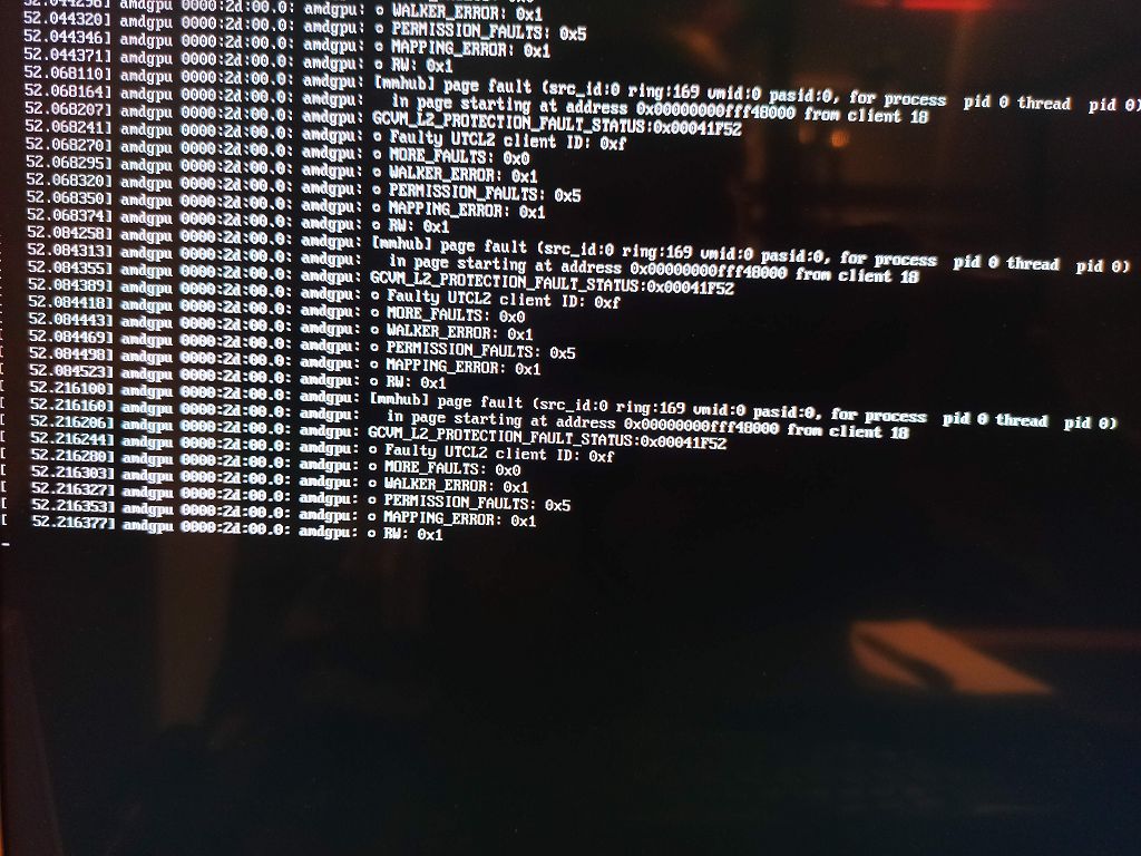

Ok I installed the driver but it seems that this makes it worse...now the system does not boot any more and I get a fault..
Amdgpu: GCVM_L2_Protection_Fault_Status:0x00041F52
I can only boot in recovery mode

- Posts: 22030
- Thank you received: 7504
28 Dec 2020 13:18 #193377
Replied by tommylight on topic Linux stuck with blinking cursor
The following user(s) said Thank You: FedX

Im sorry i dont use Linux very often.. With Kernel 5.8 everything is working fine and im finally able to use probe basic gui
On my real machine i use older Hardware an dual core Opteron and 4gb DDR with an radeon X1950pro. Is it better to use Buster there or doesn't it matter and i can use mint also? For signal generation i use a Mesa card.
