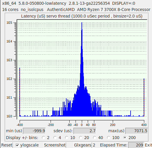

8000 ms is very good if "ms" are microseconds
8000 ms is 8 seconds is ms are milliseconds
Can you run
latency-histogram --nobase --sbinsize 2000
and post the results (screen shot) here

i meant us not ms sorry for the confusion. 8000ms would be a bit to much i guess
The latency test doc says that everything over 1000us is not suitable for linuxcnc at all, thats why i thougt the latency is quite high.
The Base jitter shouldn't matter as i will use a mesa card with the new system. But i think the servo thread should be stable for communicating with the mesa card via ethernet, right? Is there a limit ?

OK you are running a low-latency kernel, not a real time kernel, Sorry I didn't notice before.
If you need a very recent real time kernel. I suspect you will have to build it yourself, something like:
