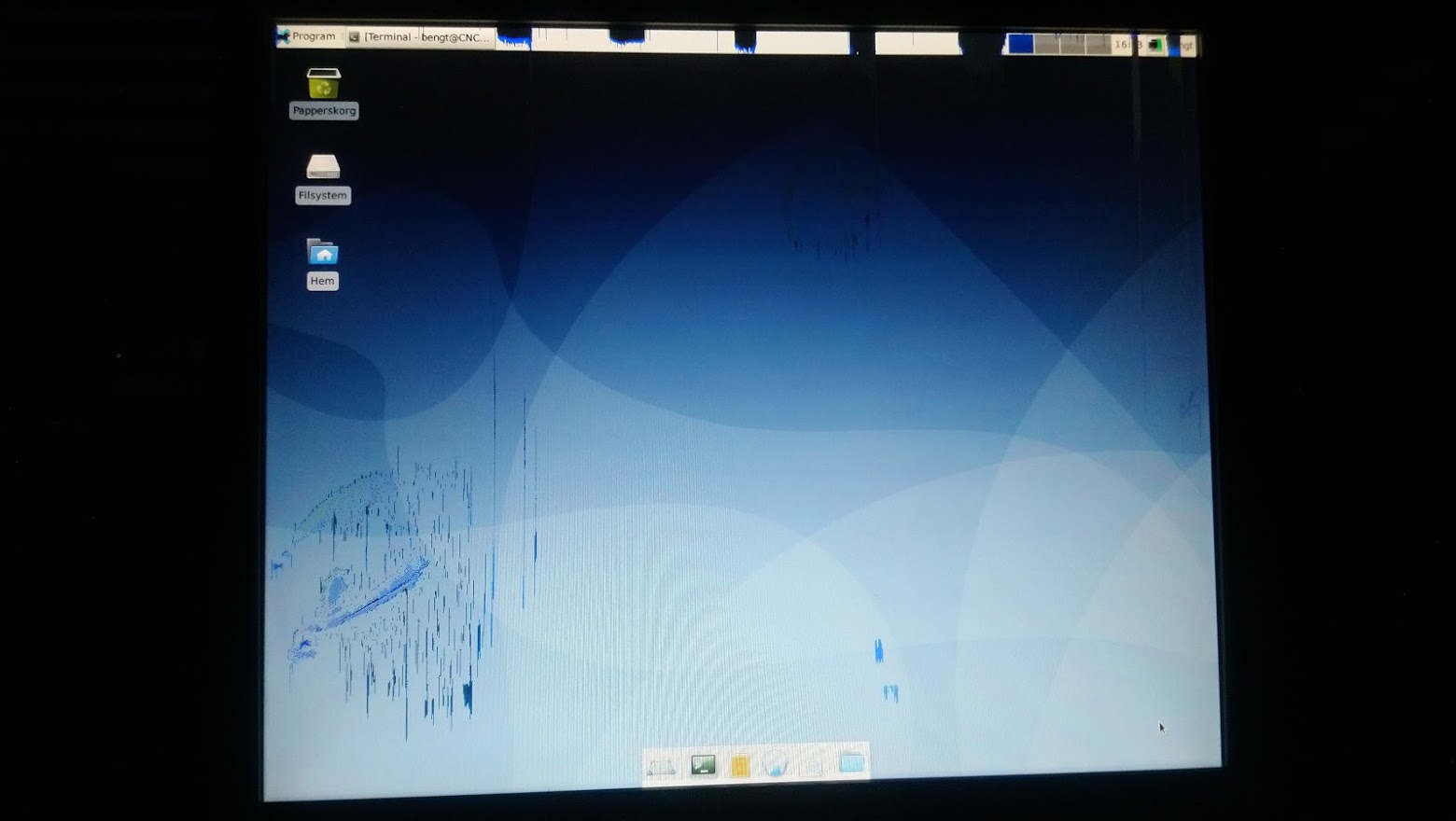

15 Jan 2021 09:20 #195441
by tecno
Replied by tecno on topic Update help
- Posts: 19904
15 Jan 2021 09:24 #195443
Replied by andypugh on topic Update help
Was it still cold?
I regularly chill laptop screens down to -30C and have never seen any permanent damage.
- tecno
- Posts: 1850
- Thank you received: 127
15 Jan 2021 09:31 #195444
by tecno
No, took it up last evening and let get room temp before I powered up.
The temp never goes lower than 3-5°C in the shop.
The monitor an old LCD from Philips 170B4 so that might explain why
- Online
- Posts: 22033
- Thank you received: 7504
15 Jan 2021 09:43 #195446
Replied by tommylight on topic Update help
I would say moisture, but it is past that, that is water ingress.
Still looks salvageable just dry it properly for at least 2 to 3 hours at 60-65 degress C.
The following user(s) said Thank You: tecno
