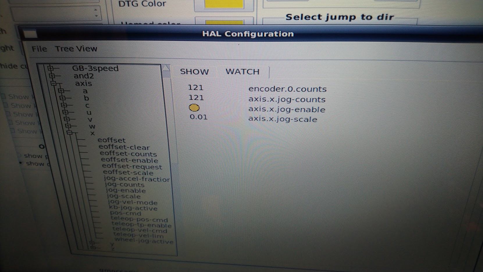

Now I have been down in the workshop and tried everything possible but nothing moves on the screen / axis.
Axis move with keyboard and touch screen.
Looks like there must have been major updates with GMOCCAPY so my old settings are no longer valid. No moves from PROBE screen either.

If you are driving the axis/joint.xxxxx jog pins correctly then the GUI is not even involved.
Though... You can't jog an axis until the machine is homed, at that point you are jogging joints. So you could check the joint jogging pins.
It sounds like motion isn't enabled, or feed rate is set to zero, or something like that.

So, there is nothing on joints!The update script has not converted all data as looks like now.

Does it jog after homing?

No
Nothing new in HALUI

It's not the unconnected joint jog enables then.

To me this looks to be unconnected
# The encoder output counts to the axis. Only the selected axis will move.
net encoder-counts <= encoder.0.counts
net encoder-counts => joint.0.jog-counts axis.x.jog-counts
net encoder-counts => joint.1.jog-counts axis.y.jog-counts
net encoder-counts => joint.2.jog-counts axis.z.jog-countsPlease Log in or Create an account to join the conversation.
