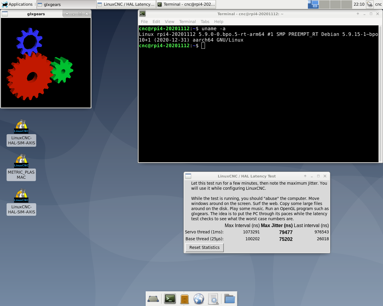

18 Jan 2021 16:22 - 18 Jan 2021 17:15 #195843 by pauluzs
I suspect that the debian packages made by that repository do not copy across all the files that the manual process does.
Which one do you mean with "that repository "?
(This is with a brand-new 2GB Pi4. Maybe I should have got the 8GB one to be a better test, but it is just that bit too expensive a thing for me to buy without needing.)
True, using bone stock 5.9 arm64 realtime kernel, only thing i did is force_turbo=1 to prevent cpu-scaling.
This is 2 min run on rpi4_4GB
Last edit: 18 Jan 2021 17:15 by pauluzs.
