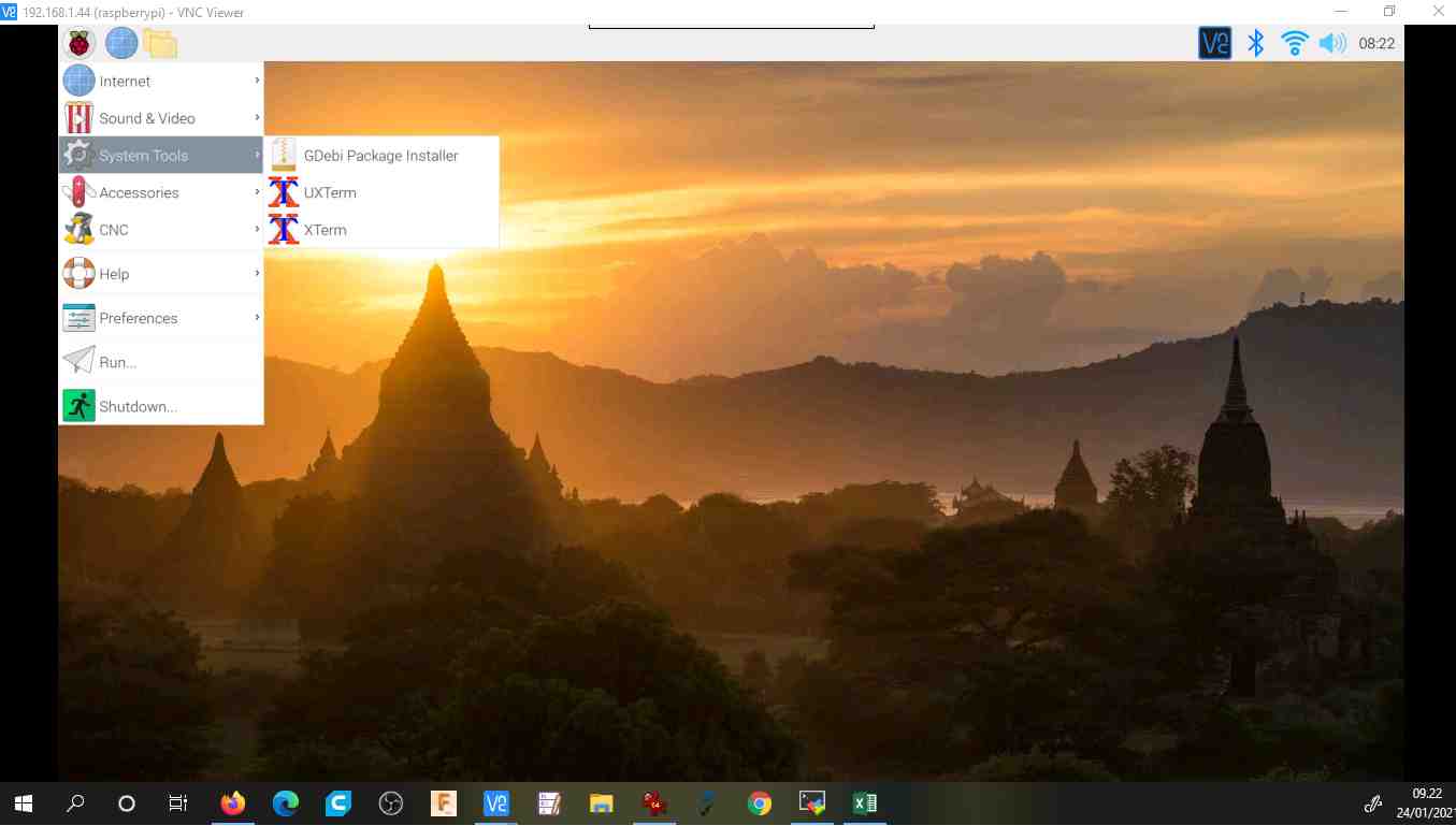

23 Jan 2021 14:34 - 23 Jan 2021 14:53 #196359
by elovalvo
I started from the lite version and only installed the essential software.
In any case, just select "UxTerm" from the "System Tools" menu.
Then run the command "sudo apt install chromium-browser"
If it is connected to the Internet, the browser installation procedure will start and you will eventually find it in the Internet menu.

23 Jan 2021 17:01 - 23 Jan 2021 17:15 #196369
by zz912
Replied by zz912 on topic Last update of LinuxCNC Raspberry Pi4 USB does not work
I did not know UxTerm = shell. Internet works from wlan.
I have>
Raspberry Pi4b 4GB.
How do I find the revision number?
I have ,momitor with resolution 1600 x 1200. Your version of Raspbian set same resolution of 16:9.
I have>
Raspberry Pi4b 4GB.

24 Jan 2021 02:41 #196385
by elovalvo
You will be able to know the revision number by typing on the terminal UXTerm
cat /proc/cpuinfo
To change resolution:
sudo raspi-config
Replied by elovalvo on topic Last update of LinuxCNC Raspberry Pi4 USB does not work

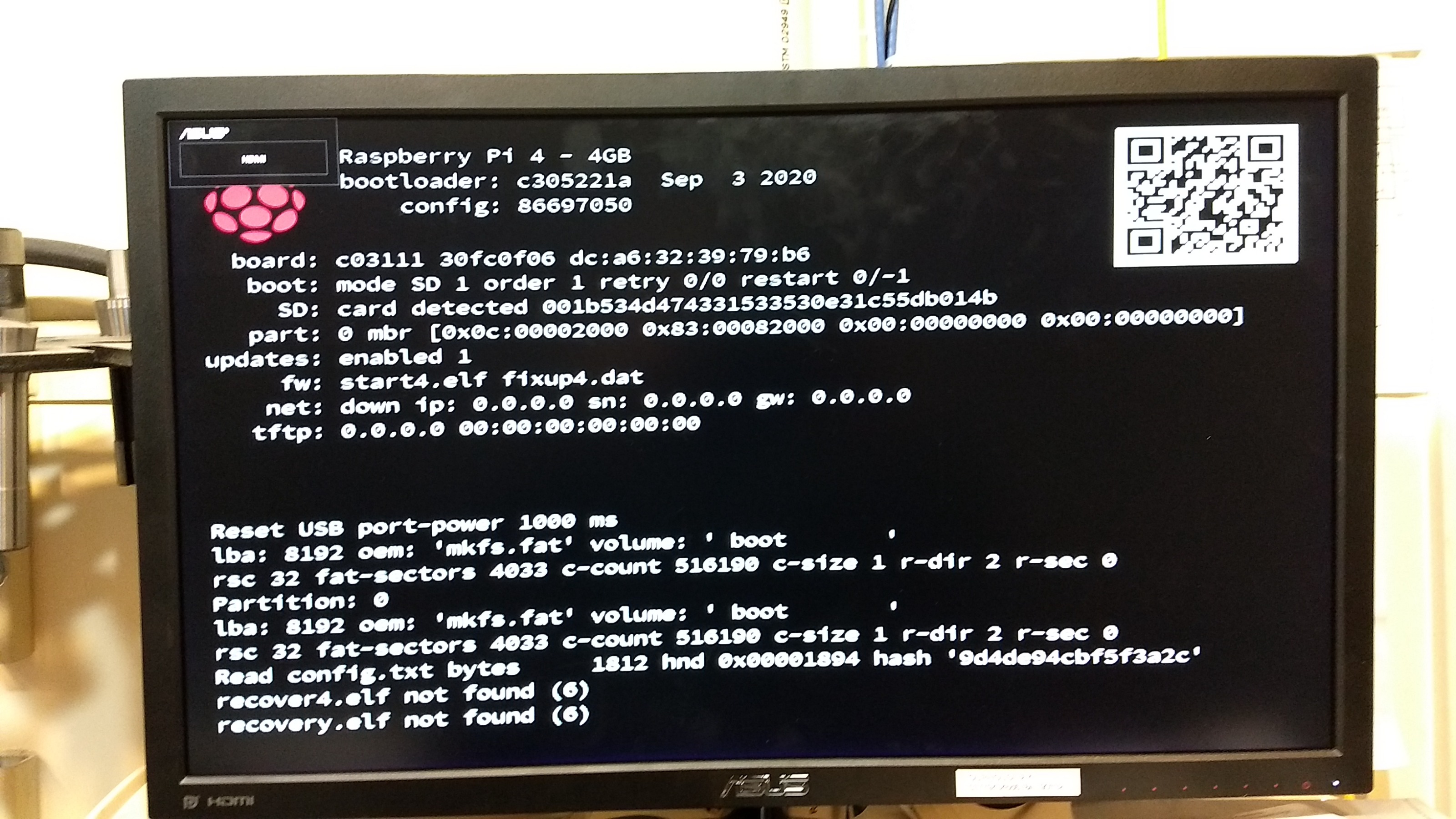

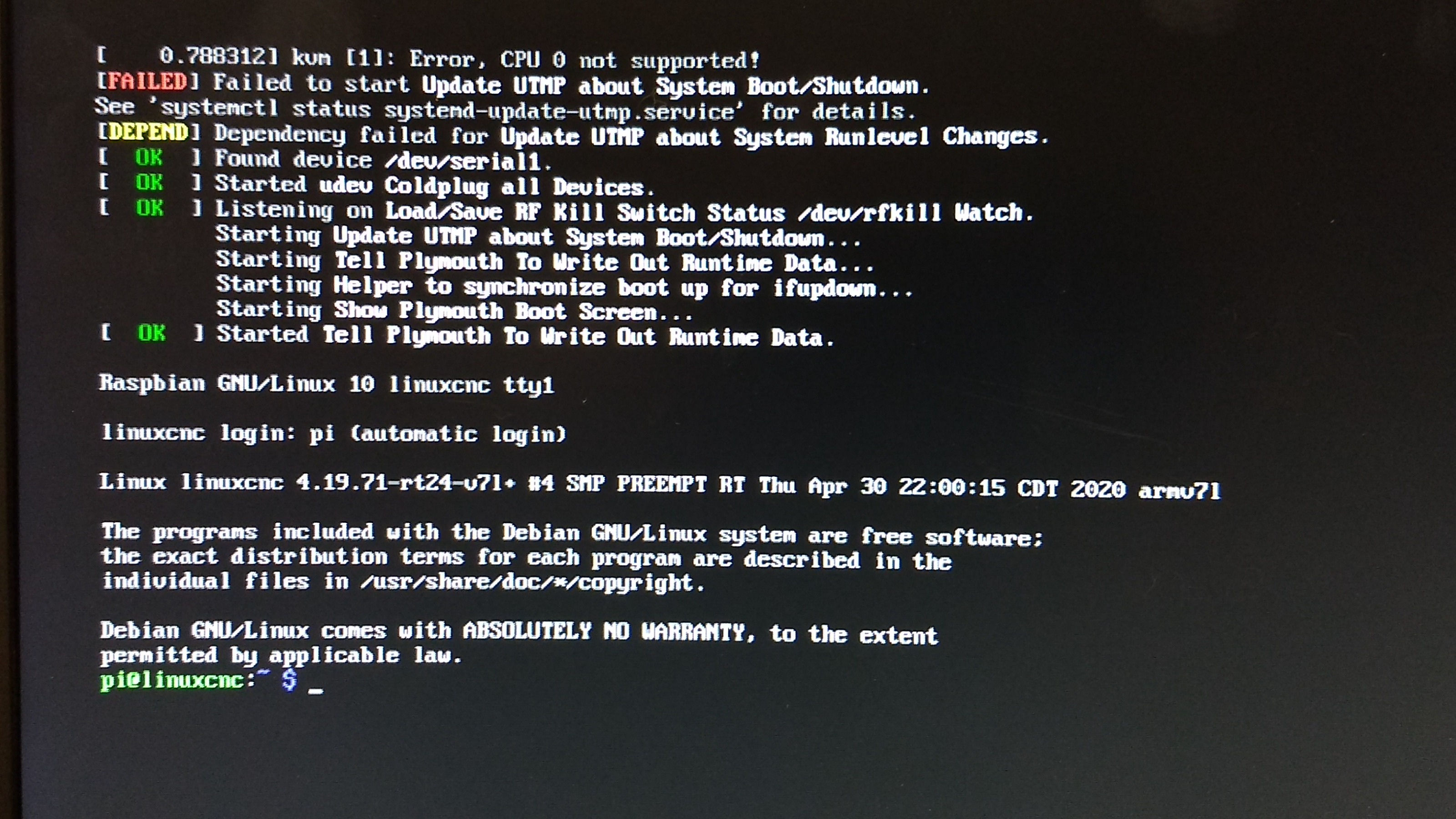

24 Jan 2021 10:08 #196421
by kramerda
Replied by kramerda on topic Last update of LinuxCNC Raspberry Pi4 USB does not work
Following up on my last comment - I reburned the same image onto the same SD card - this time the plan is to not enable wi fi for any upgrades.
But
the Rpi4 no longer boots to the desktop screen at all.
Attached are two screen shots of the monitor screen while it power up.
Sorry I don't know how to interpret the screen shots or what to try next.
Is it possible something has permanently changed in the Rpi4 -? Hope not!!!
Thanks,
Dennis
But
Thanks,
Dennis

24 Jan 2021 10:41 #196424
by kramerda
Third (last update) to todays events.
Burned image as previously describe (again) from a new down load of 2.8.0.
This time when system appeared dead - no keyboard or mouse - unplugged wireless keyboard/mouse dongle and voila - desktop screen back in business.
So no permanent bad things happened to Rpi4.
For now we'll continue and try to understand a different 'update' / 'upgrade' process in the future.
Hope these comments help others that stumbled as I did.
