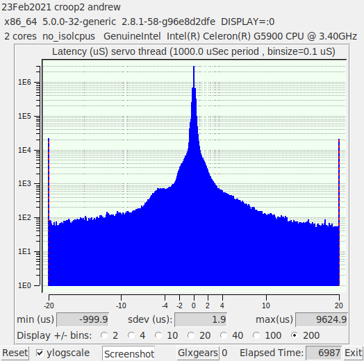

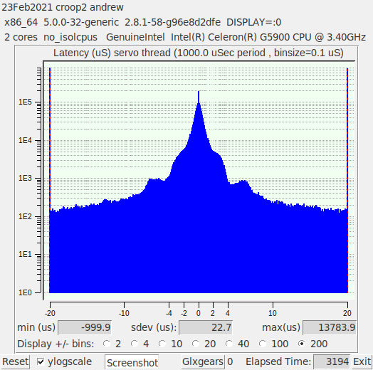

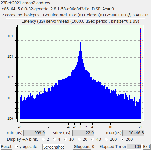

23 Feb 2021 06:50 #199821 by BigJohnT
Replied by BigJohnT on topic Install Debian 10 on ASUS PRO H410M-C
I got Linux Mint Mate 19.3 installed and used a USB NIC to get the real time kernel and installed LinuxCNC.
Sadly the latency is crazy bad.
JT
  • BigJohnT
  • BigJohnT's Avatar Topic Author
  • Offline
  • Administrator
  • Administrator
23 Feb 2021 07:40 #199824 by BigJohnT
After running the latency histogram for a while it's even worse... I think this is the worst latency I've ever seen.
JT

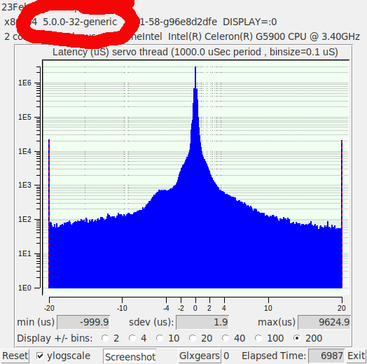

23 Feb 2021 10:36 #199849 by tommylight
Replied by tommylight on topic Install Debian 10 on ASUS PRO H410M-C
Wrong kernel JT, hold down SHIFT key when booting then chose the RT kernel, or use the Grub customizer to change it permanently.
BTW, thank you for introducing us to grub customizer several years back! :)
  • BigJohnT
  • Offline
  • Administrator
  • Administrator
23 Feb 2021 11:22 - 23 Feb 2021 11:28 #199862 by BigJohnT
Hmm, I selected the rt kernel in the grub customizer or so I thought... generic kernel would explain it for sure. Fresh eyes always spots the missed.
