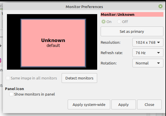

Do you have any old graphic card to test with ?
P.S.
I am aware that this is not the right time to ask for graphic cards as they are harder to find than "unobtanium" due to crypto mining frenzy going on.
Replied by tommylight on topic Install Debian 10 on ASUS PRO H410M-C
Hmmm another member of this forum had this same issue with resolution, makes me think i am very lucky as i never had it with RT kernel but i did have it RTAI kernel.Booted up to the rt kernel and now the monitor is 1024 x 768!
P.S.

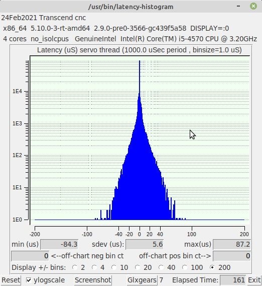

There was 5.4 that worked with LinuxCNC, there is 5.9 that has issues with everything from WiFi to.... but the good thing is if you try to install 5.9 it will warn and stop the installation.
Hmm ... just downloaded and installed
ftp.us.debian.org/debian/pool/main/l/lin..._5.10.13-1_amd64.deb
No complaints so far, leme reboot...

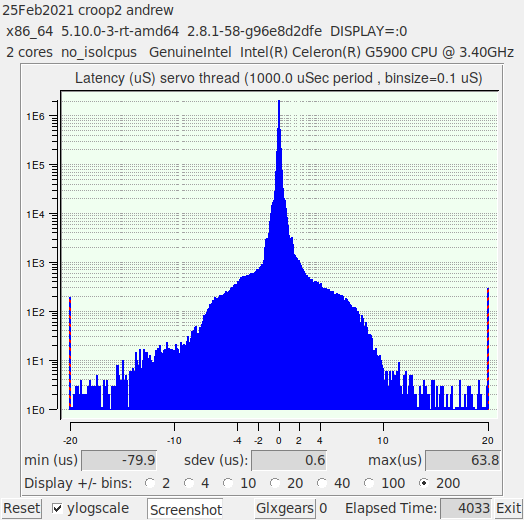

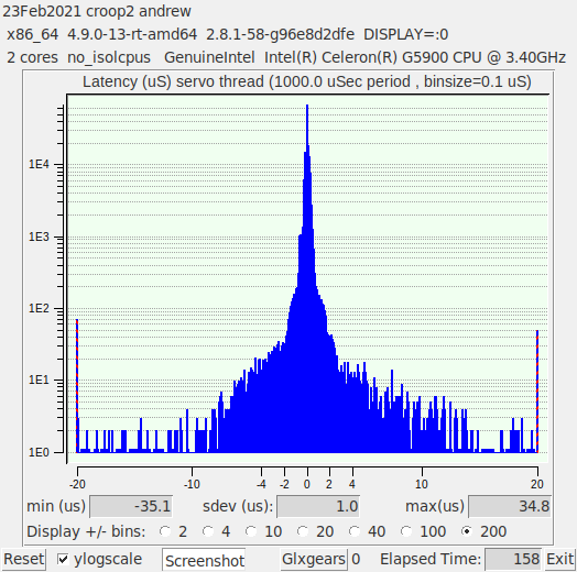

5.4 seems like it was a stepping stone same as 5.9 and the rest as they are nowhere to be found on the Debian servers.
5.10 is current stable, and it works with Mint 19.3 with just a bit higher latency numbers than 4.9 or 4.19.
Did not try on Mint 20 as i gave my big PC to my bro and i am left with 19.3 on all PC and laptops since i reverted back to it due to testing QtPlasmaC.

latency-histogram --nobase --sbinsize 1000 --show
That will show if there are spikes over what is shown in the screen.
