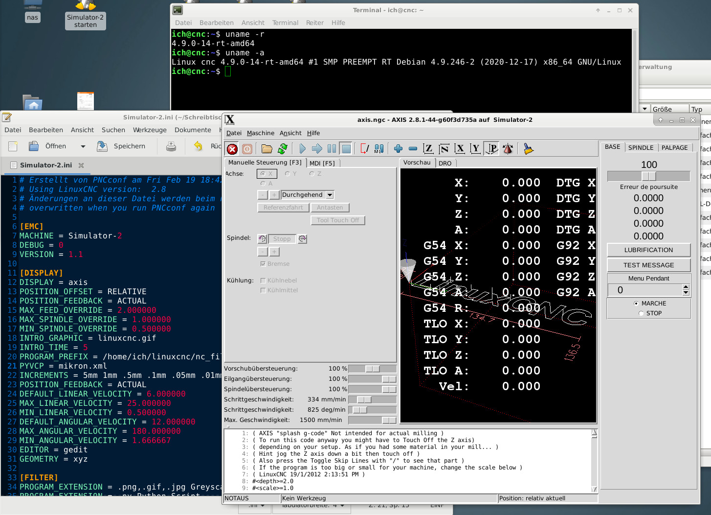

This might be a config problem.
What doestell you?
wiki.linuxcnc.org/cgi-bin/wiki.pl?LockedMemory
However on my systems this shows 65536 which should be more than enough.
Replied by andypugh on topic LinuxCNC 2.8.1 configuration doesn't run after upgrading from 2.7.15
Obviously 2.8.1 under axis limits the size of the xml file linked to PyVCP ?
What does
ulimit -lwiki.linuxcnc.org/cgi-bin/wiki.pl?LockedMemory

this gives ?
utilisation ulimit [-SHabcdefghij .....xPT] [limite]
this gives ?

- Posts: 19899
19 Feb 2021 10:56 #199399
It doesn't seem to be that, then.
If the rtapi logging level is set to 4 or 5 then the shmalloc_dn function lists the free memory and we can see if it is really running out. However setting the rtapi logging level is more difficult than it used to be. I have a very simple HAL component that calls rtapi_set_msg_level(5) when loaded.
(the error is raised here: github.com/LinuxCNC/linuxcnc/blob/master/src/hal/hal_lib.c#L703
which calls: github.com/LinuxCNC/linuxcnc/blob/master.../hal/hal_lib.c#L3020
which calls: github.com/LinuxCNC/linuxcnc/blob/master.../hal/hal_lib.c#L2959

If you load my xml file into a config of your own, do you have the same blockage?
I just tried No, on a simple configuration, my xml file works fine ?

20 Feb 2021 00:06 - 20 Feb 2021 00:08 #199488
I added your PyVCP to sim-axis/axis-9axis
I then loaded a 5i25 and a set of Mesa cards.
All was well.
I then used mux_generic to add a _lot_ of float-type HAL pins and found that the system died at 878 pins.
(actually crashed the PC, but I am running an experimental RTAI kernel)
Trying again I managed to get to 2789 HAL pins before it looked like running out of memory was likely.
To find the number of pins in your config, open a terminal (with your config running) and "halcmd show pin > pins.txt" then open the pins.txt file in a text editor with line numbers (such as Geany)
All was well.
Feb 20 00:04:14 rm-one kernel: [ 642.439483] smalloc_up: shmem available 347376
Feb 19 23:55:10 rm-one kernel: [ 642.439484] HAL: creating pin 'or2.0.in0'
Feb 19 23:55:10 rm-one kernel: [ 642.439485] smalloc_dn: shmem available 347280
Feb 19 23:57:12 rm-one kernel: [ 220.570673] smalloc_dn: shmem available 1120
Feb 19 23:57:12 rm-one kernel: [ 220.570677] HAL: creating parameter 'and2.9.tmax'
Feb 19 23:57:12 rm-one kernel: [ 220.570677] smalloc_dn: shmem available 1040
Feb 19 23:57:12 rm-one kernel: [ 220.570679] HAL: creating parameter 'and2.9.tmax-increased'
Feb 19 23:57:12 rm-one kernel: [ 220.570680] smalloc_dn: shmem available 960To find the number of pins in your config, open a terminal (with your config running) and "halcmd show pin > pins.txt" then open the pins.txt file in a text editor with line numbers (such as Geany)
Last edit: 20 Feb 2021 00:08 by andypugh.
- Posts: 19899
20 Feb 2021 00:23 #199489
It looks like HAL is limited to 348160 bytes:
github.com/LinuxCNC/linuxcnc/blob/master.../hal/hal_priv.h#L333
That does allow for a few thousand HAL pins, but perhaps that isn't always enough?
(I have checked, and ulimit -l is no help)

2052 Pins ! " quand on aime on ne compte pas ! "
my component gearboxmikron is in userspace it
does not influence, but if I remove an rt component, I gain pins in the xml (last hal loaded)
this is under 2.7.15 RTAI with max locked memory : 20480
