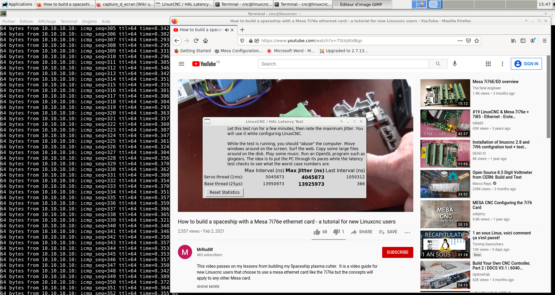

Two screens capture in attachments:

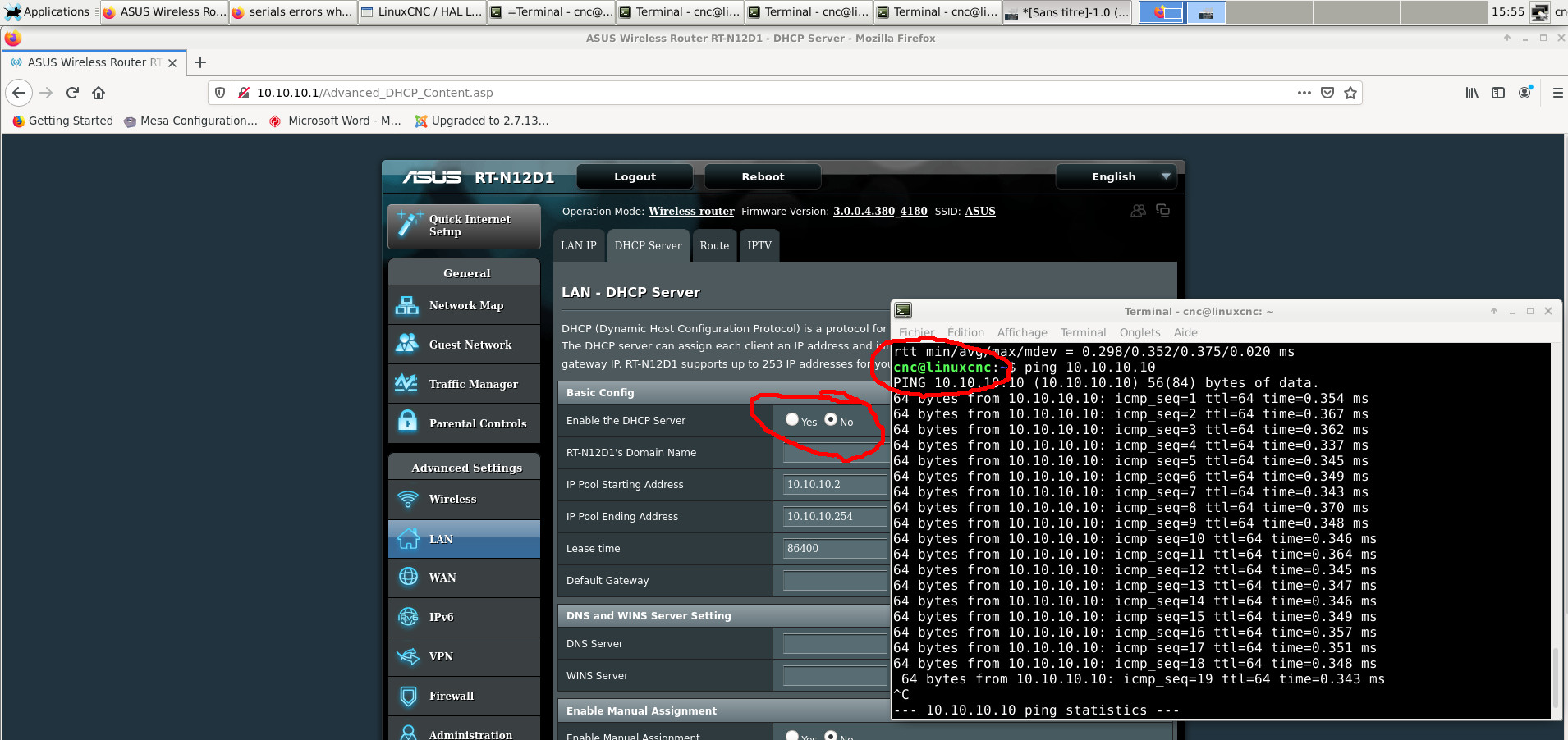

I use a switch between the card and the computer and i have disable dhcp in the switch. I have just regular cable, for a direct connection i thinks i should use a cross cable ?
Root was just for executing root command, i run linuxcnc as a regular user.

And latency is terrible, is that still under the RT kernel ? Disable everything related to power savings, hypethreading, speedstep, C states, virtualisation, etc etc, in BIOS.NO switches or HUB's in-between !
Also a normal straight cable works just fine, almost all network adapters post 2005-6 should have "auto negotiation" so cross cable is a thing of the past.

Replied by PCW on topic serials errors when connecting with my mesa 7i76 card
Note that you should not have your wireless setup on the same 10.10.10.XX
subnet, it should be left at the default 192.168.1.XX range. There is no reason
to change your router settings at all. Nothing else in the network should
be in the 10.10.10.XX range except the static IP address of the host PC and
the 7I76E card.
The latency test is probably meaningless because the PC cannot
possibly service the base thread at 40 KHz. Only the servo thread is
required. To test with only the servo thread, run:
latency-histogram --nobase --sbinsize 1000
The ping times are quite bad also. If the PC has a Intel Ethernet interface chip,
follow the instructions for disabling irq coalescing in the hm2_eth manual page
man hm2_eth
man hm2_eth
Last edit: 09 May 2021 11:20 by PCW.
