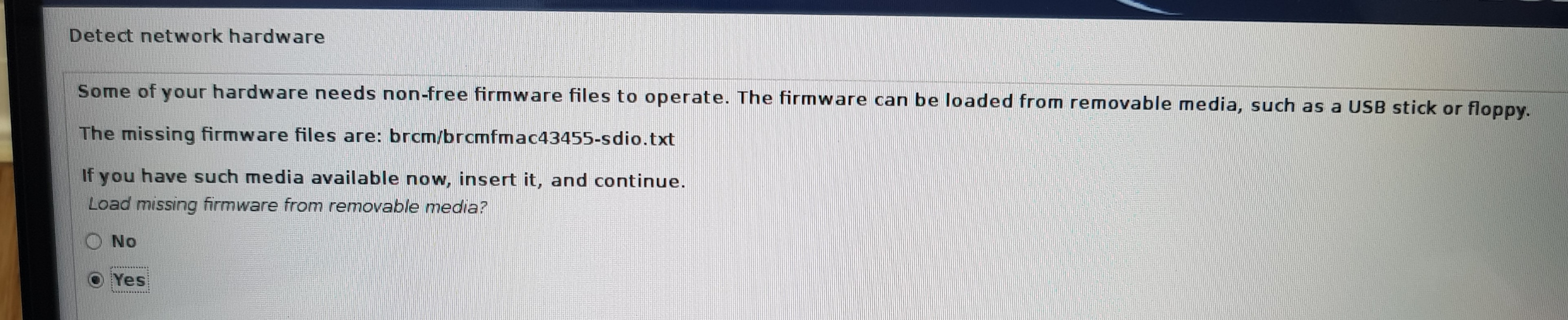

I am trying to install LCNC on a BT3 Pro II - www.getdget.com.au/beelink-bt3-pro-mini-...ows-4gb-64gb.htmlThe live boot works fine. however, when I try to install Linux, I get through to network setup, and get an error about missing file
Originally, it was looking for the same file but ending in .bin, and I found that file on the internet, and copied to USB, but am having no luck with the .txt file.
On another forum - askubuntu.com/questions/1003350/bcm43455...pter-not-recognisedI found
"On a Wintel MiniPC (AMI, T3 MRD, Atom x5-Z8350) running Windows 10, the file is found at C:\Windows\System32\drivers\4345r6nvram.txt and can be copied to Linux, then do:"
I tried copying that file, and renaming, but no luck.If I skip the file, it just hangs on configuring network.
Do I need to format the hdd to remove the windows installation?
Any other ideas?

Use the non-free version of Debian 10, or even better use this tutorial for Linux Mint 19.3:

I tried the iso file, and networking worked, but no wifi. I tried the Mint 20 install, but the system seems unstable on RT kernel. I will go to do something, and it will just freeze. Only option is to power off.

Wifi worked on Mint 20, until I installed the RT kernel, then no Wifi

I'd go with a USB wifi dongle and be done with it.
Another thing you can do is run a live session of Mint 20 and go through dmesg to see what gets loaded.
Look it just may be that that particular wifi device is not supported by a 4.19 kernel, it may need a later kernel.

If you want to use the standart installation, i found this post on ubuntu forum. The nvram.txt file is still online here:
github.com/khadas/android_hardware_amlog...cm_ampak/config/6255
Cf:
forum.ubuntu-fr.org/viewtopic.php?id=2033578
#14
Code:
wget https://github.com/khadas/android_hardware_amlogic_wifi/raw/b6709758755568e4a0ff6e80993be0fc64c77fb9/bcm_ampak/config/6255/nvram.txt sudo cp nvram.txt /lib/firmware/brcm/brcmfmac43455-sdio.txt
