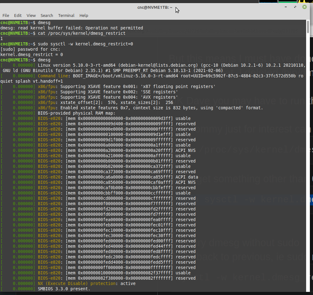

- BeagleBrainz
- Visitor
11 Jun 2021 05:36 - 11 Jun 2021 06:18 #211795
by BeagleBrainz
Replied by BeagleBrainz on topic Installing LCNC on Beelink BT3 PRO II
Is that with a standard kernel, debian rt or my rt kernel.
hmmm maybe I changed the dmesg permission
But this means I must have done it on ALL Mint installations on ALL machines, even those that have multiple versions of Mint.
Ok it's not that, I deleted /bin/dmesg then reinstalled util-linux (package for dmesg) & permissions were the same.
OK Dave you may have to run the dmesg command with sudo in front of it.
Hey Tommy just for interest can you run:If you get something other than 0 can you try,
Then try dmesg without sudo
To go back to previous, ie sudo requires dmesg
OK found out that there is a kernel config option that changes the operation of dmesg, to do with wether a user can read log.
The kernel I built, taken the default config from a std Mint kernel, allows a normal user to use dmesg without using sudo, the debian RT kernel does not allow this behaviour.
rmurphy@thinkPad-t530:~$ ls -la /bin/dmesg
-rwxr-xr-x 1 root root 72000 Sep 17 2020 /bin/dmesgBut this means I must have done it on ALL Mint installations on ALL machines, even those that have multiple versions of Mint.
cat /proc/sys/kernel/dmesg_restrictsudo sysctl -w kernel.dmesg_restrict=0Then try dmesg without sudo
sysctl -w kernel.dmesg_restrict=1OK found out that there is a kernel config option that changes the operation of dmesg, to do with wether a user can read log.
Last edit: 11 Jun 2021 06:18 by BeagleBrainz.

- Posts: 22030
- Thank you received: 7504
11 Jun 2021 15:09 #211830
Replied by tommylight on topic Installing LCNC on Beelink BT3 PRO II
Some info on the picture above, there are all the lines run and the version of kernel, all this is on Linux Mint 19.3 with all the latest updates, and sure enough the kernel is from the Debian Stretch repository.
As can be seen above, the line proposed by Beagle does it's magic and now dmesg works with no sudo privileges.
Thank you Beagle.
Thank you Beagle.
