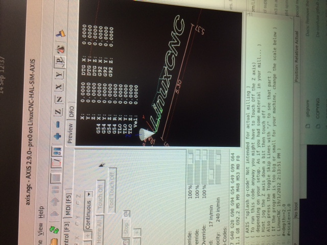

I Installed Debian 11 +linuxcnc without failures from :
linuxcnc.org/docs/devel/html/code/buildi...g-Build-Dependencies
. All tests are pass.
But when starting linuxcnc axis it started 1 time with this log file :

And will not start anymore ???? What did I do wrong?
thanks, Hans

5 years 1 month ago #220581
by hhogendoorn
Replied by hhogendoorn on topic Buildbot + Debian 11 / Bullseye Questions
- hhogendoorn
- Posts: 14
- Thank you received: 3
5 years 1 month ago - 5 years 1 month ago #220584
by hhogendoorn
See answer below, it worked perfect , started with "linuxcnc" command. But after restart the pc I can not get it to work ?? linuxcnc: command not found.
How to do the "install" instead "run in place"
(ps new to linux hi)

5 years 1 month ago #220585
by phillc54
Replied by phillc54 on topic Buildbot + Debian 11 / Bullseye Questions
For a run in place install you could use:
Code:
~/linuxcnc-dev/scripts/linuxcnc
The following user(s) said Thank You: hhogendoorn

5 years 1 month ago #220590
by hhogendoorn
That's the trick! ok thanks
