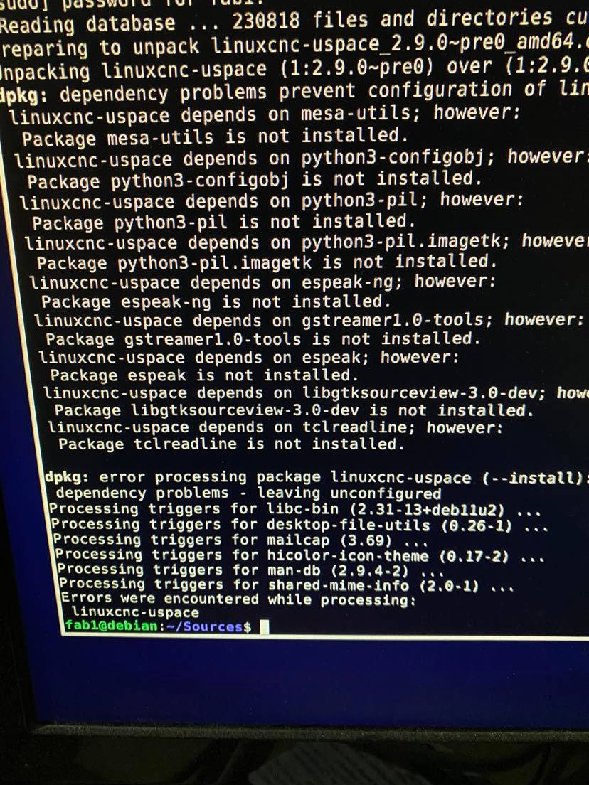

12 Nov 2021 00:51 #226166
by bevins
Replied by bevins on topic Buildbot + Debian 11 / Bullseye Questions
Yeah, I rebooted and am using the rt kernelDid you reboot to RT kernel ?

12 Nov 2021 01:55 #226172
by bevins
ok got it. Weird. --fix-broken installed the deps needed. Linuxcnc starts up now.
