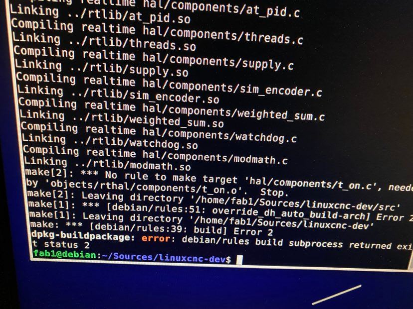

11 Nov 2021 20:54 #226140 by bevins
Replied by bevins on topic Buildbot + Debian 11 / Bullseye Questions
I installed Debian 11 Bullseye and got the rt kernel. no issues so far. Got the sources and went to compile a deb and it is failing with whats in the pic. Anyone know what's going on?
11 Nov 2021 21:07 #226142 by andypugh
Replied by andypugh on topic Buildbot + Debian 11 / Bullseye Questions
My fault. Pull and try again.
The following user(s) said Thank You: bevins
11 Nov 2021 21:25 #226144 by rodw
Bevins, there has been changes to the deb build process so Linuxcnc can be included in the Debian repos. I found one issue which was reported and resolved. If you see some errors about permissions add -rfakeroot  to the build package command
Andy, for some reason I've noticed some commits changing the docs are not flowing through to the web site docs. it would be good if that could be done so that change is reflected in the docs.
Anyway, the amazing thing is that linuxcnc is sitting in the debian in queue for inclusion in debian 12!
11 Nov 2021 21:40 #226146 by bevins
Thanks, got through that point.
