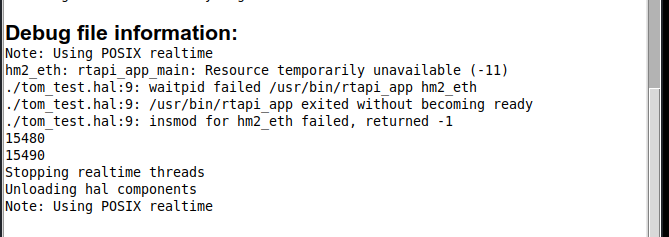

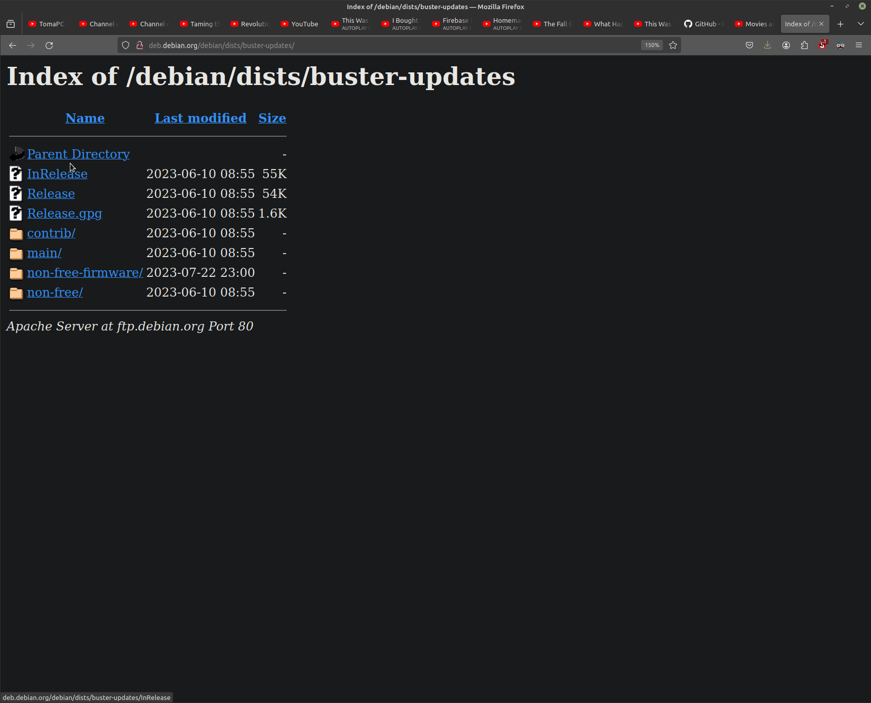

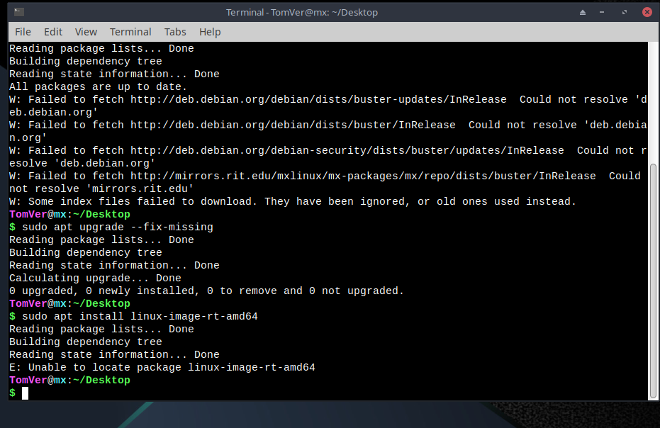

Well I have blown most of the day trying to get things going. Linux seems to be constantly changing. I have gone through the install many times today and hit a brick wall. First problem was getting the bios so it would see the hard drive after reboot, on this Dell it must be in legacy. I did get it to do the install for MX and boot fine after that. But down where update and upgrade section. See attached screen shot, it could not fine the files to upload. Also if you remove the USB stick before the install shuts down it will not shutdown on it own. I keep getting the goal posts being moved.

Screenshot is a network issue, namely there is no network connection at all, be it not configured or configured for Mesa, or bad cable/connectors not plugged all the way in.
See attachment, the first repo is active and working.

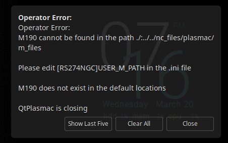

Thanks I got just about finished, this is the error I get when starting any of the QTPlasmaC operations
I have little experiences with Linuxcnc and don't know what or how to correct this.

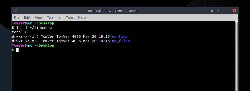

Can you open terminal and post the result of these commands:
ls -l ~/linuxcnc/
ls -l ~/linuxcnc/nc_files/
l = lower case L

Thanks for the reply here is the result and the files for that QTPlasmaC.
Replied by acourtjester on topic LinuxCNC Install using MX Linux 19.4 - Geared Toward New Users

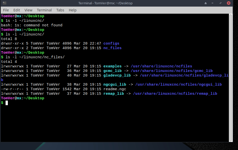

Sorry, I may have edited my post after you saw it, could you do the two directories in the edited post.

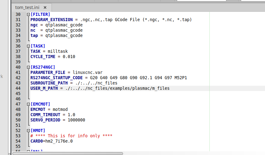

Give this a try, in the [RS274NGC] section of the .ini file change:
to:
./:../../nc_files/plasmac/m_filesto:
./:../../nc_files/examples/plasmac/m_filesPlease Log in or Create an account to join the conversation.
