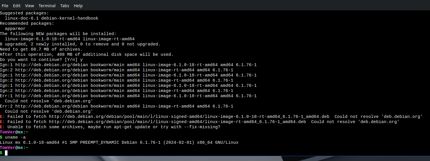

I am on a new install as instructed above and cannot get the RT files loaded as shown in the screen shot below. this is procedure I followed Section 4 - Required - Configure MX Linux 19.4 OS (cont.)17. Enter the following command: sudo apt update Note: The user will be asked to input the user password (which will not show up when typed in) 18. Enter the following command: sudo apt upgrade --fix-missing Note: Enter a “Y” if prompted “Do you want to continue? [Y/n]”19. Enter the following case sensitive command: sudo apt install linux-image-rt-amd64 Note: Enter a “Y” if prompted “Do you want to continue? [Y/n]”20. Enter the following command: sudo shutdown -r now Note: The computer will now reboot21. After reboot, open a new terminal window and enter the following command: uname -a Note: The results must contain “rt” in the kernel name similar to the picture below.f the results do not show this, follow the steps on the next slide.and the next page too step 4 does not show the RT files to change the boot option

Looks like you installed MX Linux 23 which is based on Bookworm instead of 19.4 which is based on Buster. To my knowledge MX Linux 23 does not have a "rt" kernel.
I am not sure the reason you strayed from the doc to 23 instead of 19.4, but if you are looking for something newer than Buster and wanted to stay with MX Linux, you could do MX Linux 21, based on Bullseye.
That said, most of my dev work is done on 19.4, and my plasma table also runs 19.4. That said, I know nothing about your setup

It looks like the link to the ISO gets corrupted in the PDF and it then points you to the latest version.
Try this one:
Try this one:
https://sourceforge.net/projects/mx-linux/files/Old/MX-19.4/MX-19.4_x64.iso/download

On my Mac in both Safari (browser) and Preview (file viewer) if I click the link then copy/paste the result is:
If I highlight all the text then copy/paste the result is:
It obviously puts a newline where the link is split.
https://sourceforge.net/projects/mx-linux/files/Old/MX-19.4/MX-If I highlight all the text then copy/paste the result is:
19.4_x64.iso/downloadIt obviously puts a newline where the link is split.
