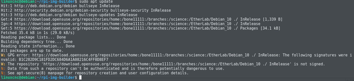

I think the stage here needs a little work
github.com/djsftree/rpi-img-builder/blob...scripts/uscripts#L44
We're not pickng up the key stored.
Should this be
deb [signed-by=/usr/share/keyrings/ethercat.gpg] ... .... ?
Should this be

16 May 2022 12:04 - 16 May 2022 12:08 #243078
by ftree
Replied by ftree on topic RPI4 - Debian Bookworm / LinuxCNC / EtherCAT / XFCE
Last edit: 16 May 2022 12:08 by ftree.
- ftree
- Posts: 116
- Thank you received: 10
16 May 2022 14:12 #243082
by ftree
Until I can figure out how to import the right keys from EtherLab repo
github.com/djsftree/rpi-img-builder/comm...ed32642c661b2b26291b
echo "deb [allow-insecure=yes] https://download.opensuse.org/repositories/home:/bone11111:/branches:/science:/EtherLab/Debian_11/ ./" >> /etc/apt/sources.list
apt update --allow-unauthenticated
apt install -y --allow-unauthenticated ethercat-dkms libethercat libethercat-dev ethercat-masterPlease Log in or Create an account to join the conversation.

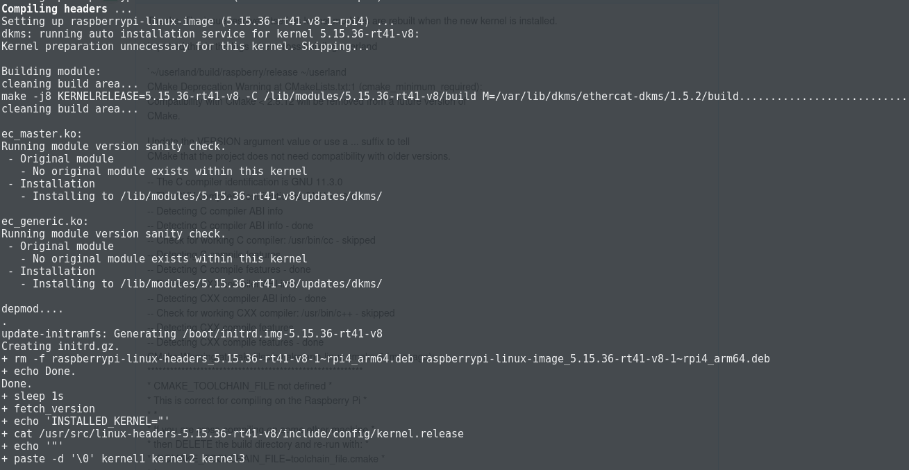

16 May 2022 14:23 - 16 May 2022 14:24 #243083
by ftree
Last edit: 16 May 2022 14:24 by ftree.
- ftree
- Posts: 116
16 May 2022 15:09 #243084
by ftree
Tested - boots to login ok!
