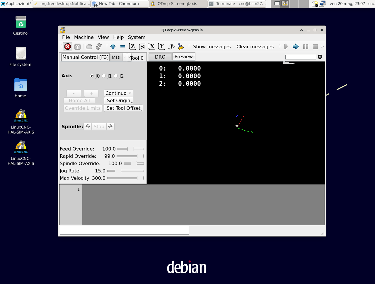

20 May 2022 15:55 - 20 May 2022 16:12 #243432
by elovalvo
The problem is related to the installation of lxde.
As suggested in
github.com/gnome-pomodoro/gnome-pomodoro/issues/344
you have to add in /usr/share/dbus-1/services/
the file named
org.freedesktop.Notifications.service
containing this
Replied by elovalvo on topic RPI4 - Debian / LinuxCNC / EtherCAT / XFCE
elovalvo's method to install qtvcp did not work for me, At least the install script ran perfectly instead of erroring. I was getting segmentation faults with qtplasmac, and other sample screens did not load.
As suggested in
the file named
containing this
[D-BUS Service]
Name=org.freedesktop.Notifications
Exec=/usr/lib/notification-daemon/notification-daemon
Last edit: 20 May 2022 16:12 by elovalvo.

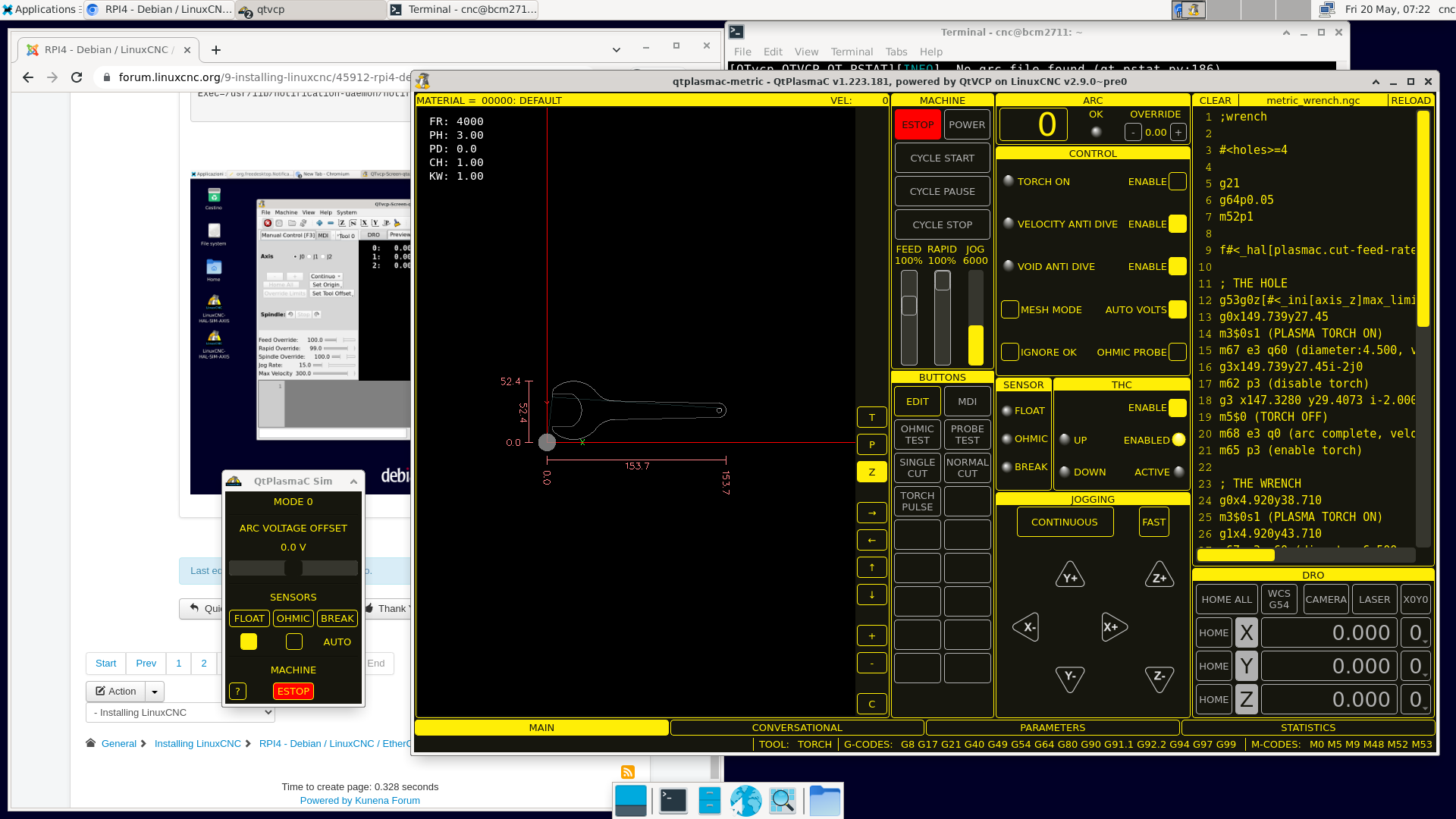

20 May 2022 17:09 #243437
Excellent!, that did the trick!
ftree, we need to create
/usr/share/dbus-1/services/org.freedesktop.Notifications.service
with that content above
The QTPYVCP guys have been kind to us and have contributed a .deb file for vtk and a simple test file. Downloading the .deb file now. 477mb does not lend itself to being shared on the forum!
My little SSD filled up so I had to blow away all my vtk stuff except the wheel but it was looking for a missing module when I installed with pip.
