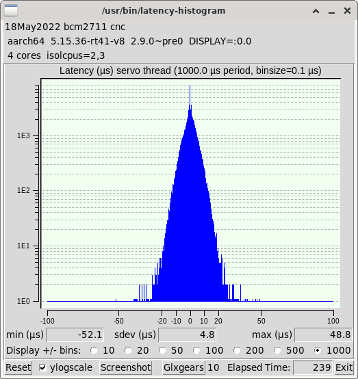

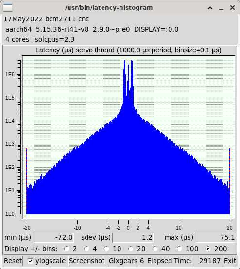

elovalvo's method to install qtvcp did not work for me, At least the install script ran perfectly instead of erroring. I was getting segmentation faults with qtplasmac, and other sample screens did not load.
but adding
to cmdline.txt made a substantial improvement on latency
10 glx gears vs 6 previously. I'll let it run overnight again.
I just have to try qtpyvcp but that will be another night.
I did grab a 64 bit SD card today so its time to try rebuilding the image tomorrow.
We had incessant internet outages today so could not get any work done, let alone playing with this..
but adding
processor.max_cstate=1to cmdline.txt made a substantial improvement on latency

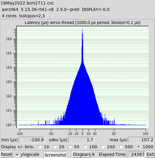

Just experiment with cstates before adding to your image. I just realised the horizontal scale was different between my overnight runs so it might be worse..

There are some red dots on that graph so might have excursions that are out of visible area, use this
latency-histogram --nobase --sbinsize 1000 --show
