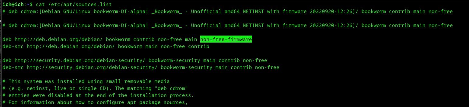

I found the non-free firmware drivers shifted from non-free to non-free-firmware section in bookworm. After setup in /etc/apt/sources.list you could install "sudo apt install firmware-realtek" realtek firmware drivers. I am unsure what is the better option, dkms or non-free-firmware. Give it try...
