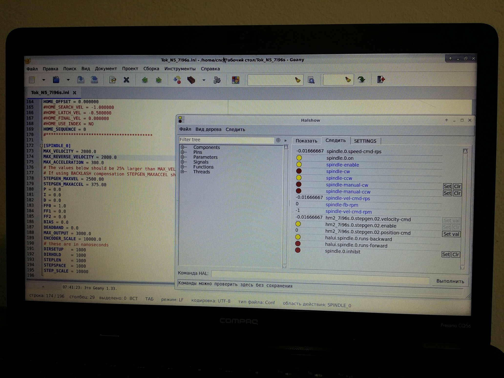

As you can see
here
the forward command works correctly with spindle.0..
But the backwards NOT.

12 Dec 2022 02:02 #259245
by xenon-alien
Added this line
MAX_REVERSE_VELOCITY = 2000.0
This - not.
Replied by xenon-alien on topic How to Install LinuxCNC?
This helped.If you are using LinuxCNC v2.9 or 2.10 then maybe try adding MAX_REVERSE_VELOCITY to the INI file?
linuxcnc.org/docs/devel/html/config/ini-...:ini:sec:spindle-num
Added this line
if you do M5 and then M4 is it the same?
What does M3 S-500 do?
This - not.
- Posts: 19904
13 Dec 2022 19:46 #259392
Replied by andypugh on topic How to Install LinuxCNC?
So, it now goes in reverse at 1rpm.
Does it only do 1 rpm in both directions?
