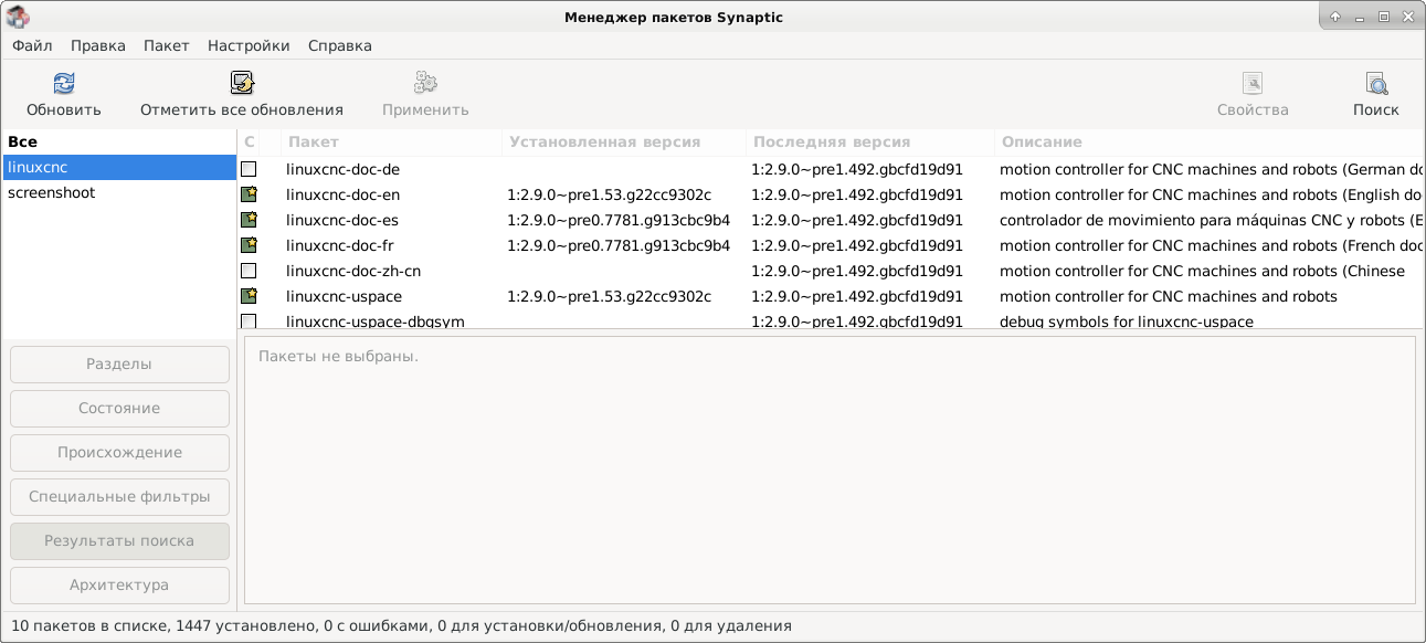

13 Feb 2023 07:28 #264428
by xenon-alien
In Synaptic I have this repository and see this... Can I upgrade?
Replied by xenon-alien on topic How to Install LinuxCNC?
Hello.Yes, there are now 2.9 debs (only for buster) on the buildbot.
Either grab them manually from buildbot.linuxcnc.org/dists or guess the new repository description (almost certainly
deb buildbot.linuxcnc.org/ buster 2.9-rtpreempt

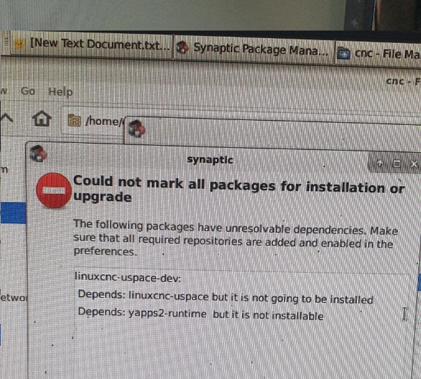

16 Feb 2023 08:22 - 16 Feb 2023 08:24 #264619
by REX299
Replied by REX299 on topic How to Install LinuxCNC?
Hello, can anyone can install 2.9 pre for this time? The repository show version 2.9 but I cant upgrade or do a new installing. It show error (picture attached). Can you show me the solution. Thanks!
Last edit: 16 Feb 2023 08:24 by REX299.
