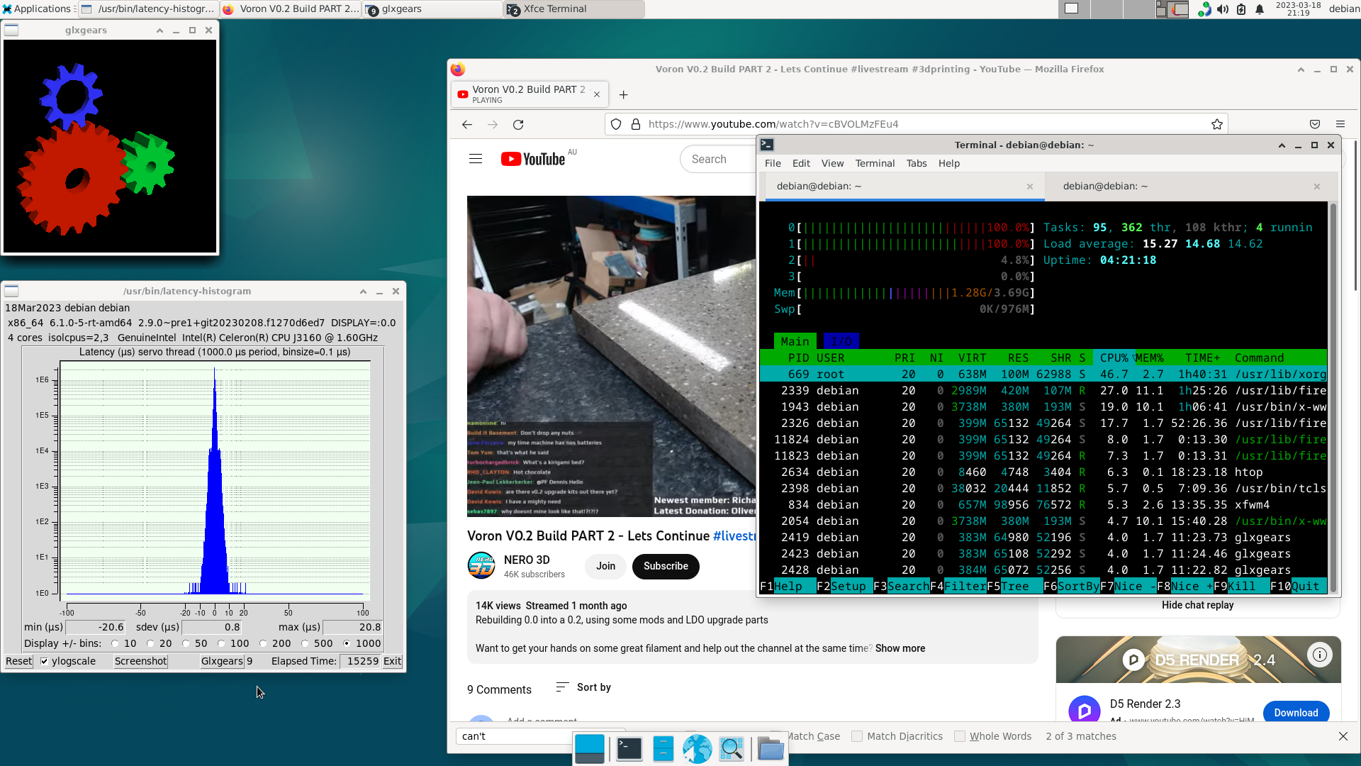

The case for Debian Bookworm and the 6.1 kernel (including installation notes) was created by rodw
This screen dump is from a fairly old Gigabyte Celeron N3160 USFF that was the first PC I used on my plasma cutter when I started with linuxcnc about 7 years ago. Back then, the latency was around 130,000 and now its down to 20,000 after 5 hours or so. That's the power of Debian Bookworm and isolcpus!
I find htop interesting to observe the CPU load on individual cores. We have isolates cores 2 & 3 of this four core device exclusively for real time PREEMPT_RT. You can see that cores 1 & 2 are hovering around 100% CPU utilisation yet the real time cores are barely doing anything. We even have an ethercat master installed talking to two slave devices during this test.
I think the added performance is due to the decision by Debian to include the non-free drivers in ther Bookworm alpha2 release and the continual improvement in PREEMPT_RT. A lot of the patches have been ported to the main line kernel code so the patch is a lot smaller than it was with Buster which is used by the linuxcnc ISO.
You to can enjoy this level of performance by following these installation steps I have put together.
docs.google.com/document/d/1jeV_4VKzVmOI...diY/edit?usp=sharing
This method obsoletes a number of installation threads, so mods may give consideration to making this a sticky and unstickying some of the other stickied installation threads. Just be careful to follow the instructions, particularly the ethercat section if you use it.
Last edit: 18 Mar 2023 06:48 by rodw.

I suspect that is how the kernel avoids assigning work to isolated cores, if they are busy, no use in giving them more work.
Replied by tommylight on topic The case for Debian Bookworm and the 6.1 kernel (including installation notes)
Do they stay at 100% even when idle?You can see that cores 1 & 2 are hovering around 100% CPU utilisation yet the real time cores are barely doing anything.

Replied by rodw on topic The case for Debian Bookworm and the 6.1 kernel (including installation notes)
Tommy, the cores are isolated so they are only for use by real time threads which have to be instantiated differently to a normal thread. (eg our sevo thread). If they are not doing anything, there is no load. So user space only runs on the non isoated cores.
Core 0 by default gets a lot of routine housekeeping interupts from the Linux operating system so never isolate core 0.
With an Odroid N2+ 6 core ARM PC using isolcpus=2,3,4,5 I could see CPU load on the user cores (0 & 1) with every instance of glxgears I added. At about 8 instances, the CPU was at around 90% utilisation and latency went out the window if I added more. In similar testing, the latency was around 70,000, still a lot better than what this PC used to get on Mint 17.3 back in the day..
Also back then it was not possible to use the internal wifi as latency blew out to >300,000. now I'm using it with no ill affects to latency.
