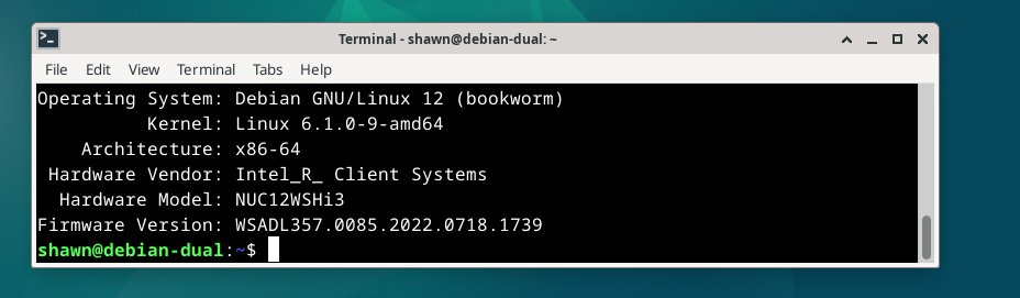

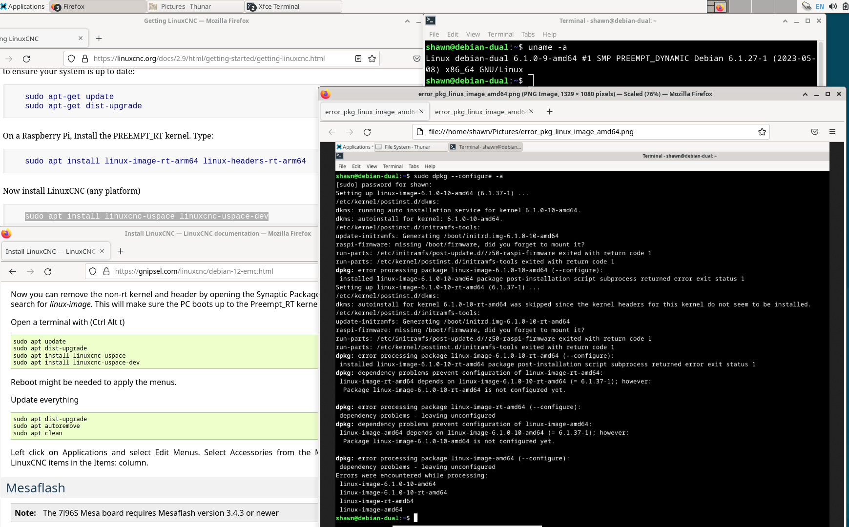

Presently, Debian 12 Linux 6.1.0-9-amd64. Error processing package linux-image-rt-amd64 at the Xfce Terminal. How is please completely install the latest version of LinuxCNC to Debian 12?

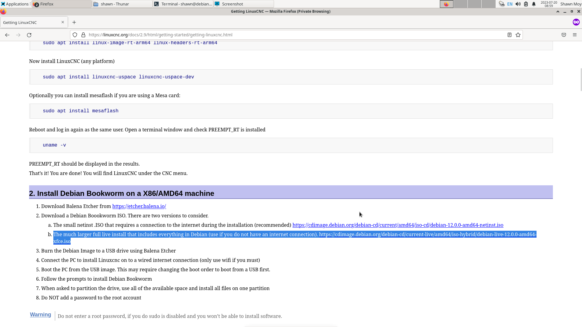

Installing on a Raspberry Pi on Debian 12 is covered on the docs
linuxcnc.org/docs/2.9/html/getting-start...etting-linuxcnc.html
It's a bit different to a X86 PC

Just follow the instructions and it works. It clearly shows you need to install the linux-image before linuxcnc on a Raspberry Pi.
Also note that if you wish to use the PI's GPIO's you have to install from source to capture a recent change. There is no prebuilt package.

Yeah but rod if you have a look at the output of his uname -a it shows and amd64 kernel.

Look closely at what you typed, you somehow mixed up arm64 and amd64.Presently, Debian 12 Linux 6.1.0-9-amd64. Error processing package linux-image-rt-amd64 at the Xfce Terminal. How is please completely install the latest version of LinuxCNC to Debian 12?

Open a file explorer as root, open the /etc folder, search for " raspi", there will be 3 files in 2 folders containing that in the file name, delete all 3 files.
sudo apt upgrade
Or
sudo apt install
Should finish fine.
Do not use dpgk, use apt.
sudo apt upgrade
Or
sudo apt install
Should finish fine.

I probably downloaded than xfce.iso for the Debian 12 install and if that's the discrepancy installing the latest LinuxCNC completely. Can LinuxCNC still be installed?
I checked the Debian /etc folder and didn't find any 'raspi' files. Could I please get more detail?
