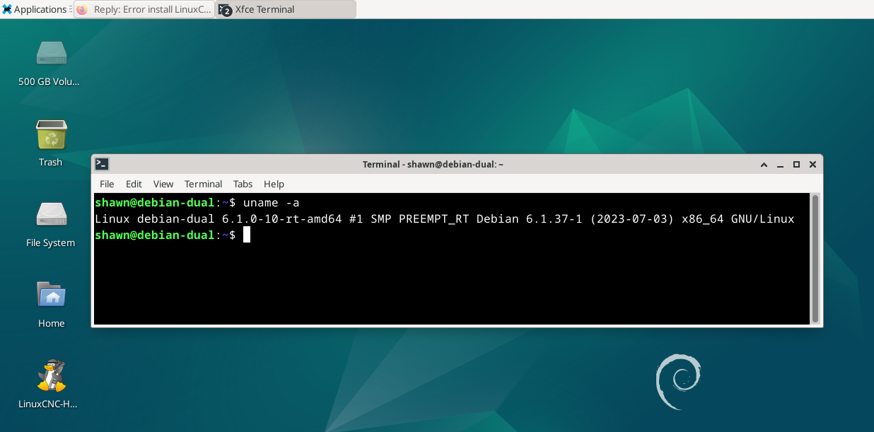

Replied by rodw on topic Error install LinuxCNC to Debian 12
Umm, your ubuntu is not running preempt_rt and I think it is a paid option. You can't control a machine with Linuxcnc without it.Thanks. However, the Ubuntu 22.04.01 remains installed. Disabling Secure Boot at UEFI Firmware Settings allowed me to dual boot. The Grub might require an update-grub if Secure Boot enabled. www.linuxfoundation.org/blog/blog/classi...ting-grub-2-on-linux

22 Jul 2023 09:54 #275996
by smplc
Replied by smplc on topic Error install LinuxCNC to Debian 12
LinuxCNC is installed on Debian 12 presently Preempt-RT. The Ubuntu is a separate operating system. However. Did Debian and LinuxCNC require another Linux operating system to cross function because Debian too lightweight generally?

22 Jul 2023 16:36 #276027
I don't know where you got the idea about Linuxcnc requiring anything but Debian.
Debian is certainly not lightweight. Ubuntu is actually a fork of Debian.
So if you have Debian and Linuxcnc on your system, why add another Linux distro?
Linuxcnc will run on most flavours of Linux but you may need to compile from source if Debs are not supported.
Debian Bookworm is running kernel 6.10 vs Ubuntu's 5.19.
Normally that is not an issue but in recent times, performance has been improving with each version of the kernel so 6.x is an advantage.
Plus Ubuntu only release the real time kernel with a pro subscription. Debian is truly open source so its included.
Sure you could build the RT kernel from source, but with Debian its all done for you.

Replied by Cant do this anymore bye all on topic Error install LinuxCNC to Debian 12
I think the issue was installing the RT kernel on Debian cos for some reason someone at Debian was asleep at the wheel and added the RPi stuff to the amd64 distro (not the net install).

22 Jul 2023 21:13 #276047
In any case, Debian 12.1 was released yesterday and the rpi issue should now be fixed in that release.
Ref: www.debian.org/News/2023/20230722#:~:tex...20serious%20problems.
