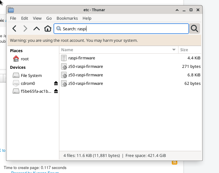

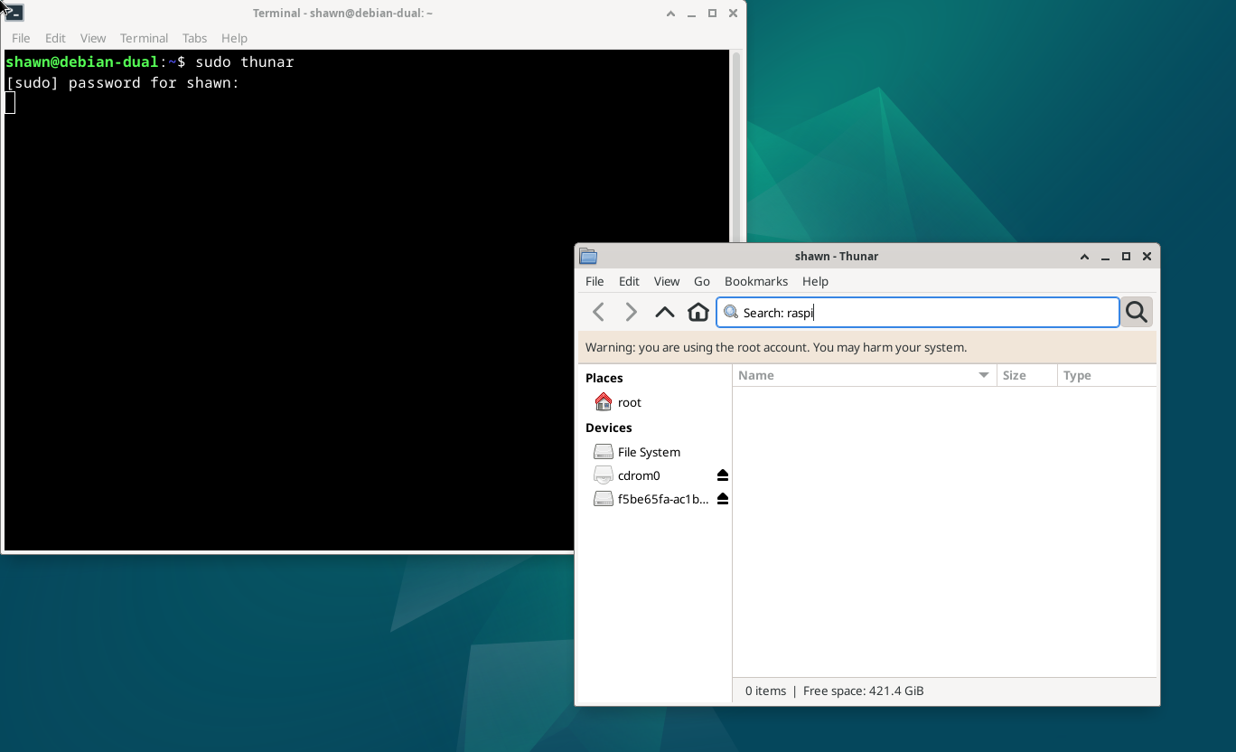

I typed 'raspi' in the search box of file explore but nothing recoverable. Is please an alternative?
I powered-off and on the PC to boot into Ubuntu 22.04.2 LTS to see if 'raspi' is recoverable because Ubuntu search explorer is more extensive both hard drives. However, the boot Grub came up instantly and I tried to boot the Ubuntu OS but denied because the kernel needs to loaded. This wasn't an issue before I installed Debian 12. I wonder if it has something to do with the xfce-iso. How do I get the Ubuntu kernel now and will it be recognizable upon booting next time?

You are not searching inside the /etc folder.
Select file system on the left, double click on ETC, press CTRL+F, type raspi, wait, select all 3 files and delete them.

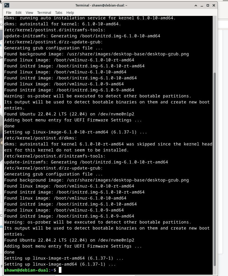

Thanks. I finished installing the latest LinuxCNC.
Now, I still need to load the kernel for Ubuntu. I see when doing the upgrade in the Debian terminal it showed 'Found Ubuntu 22.04.2 LTS (22.04) on /dev/nvme0n1p2' 'Adding boot menu entry for UEFI Firmware settings ...' 'done'. The NVMe would be my other internal hard drive and primary OS Ubuntu. It's files appear intact. That drive is accessible from Debian 12 either icon select or probably from the Debian directory. The Ubuntu terminal maybe accessible from its directory too if known what file it's in. Is a command and which one in the terminal to load the Ubuntu kernel? Or. Can it get loaded from the Grub menu and remain recognizable?

then we come to dkms errors. DKMS compiles drivers on the fly for all kernels in the system so that a kernel upgrade or selecting another on on the system in grub you are covered. But DKMS requires the header files.
I think if Debian made a mistake and included some ARM stuff, it would not be an issue as it would not build under DKMS.
I would not try to use Ubuntu with Linuxcnc. Stay loyal to our Debian partners!
