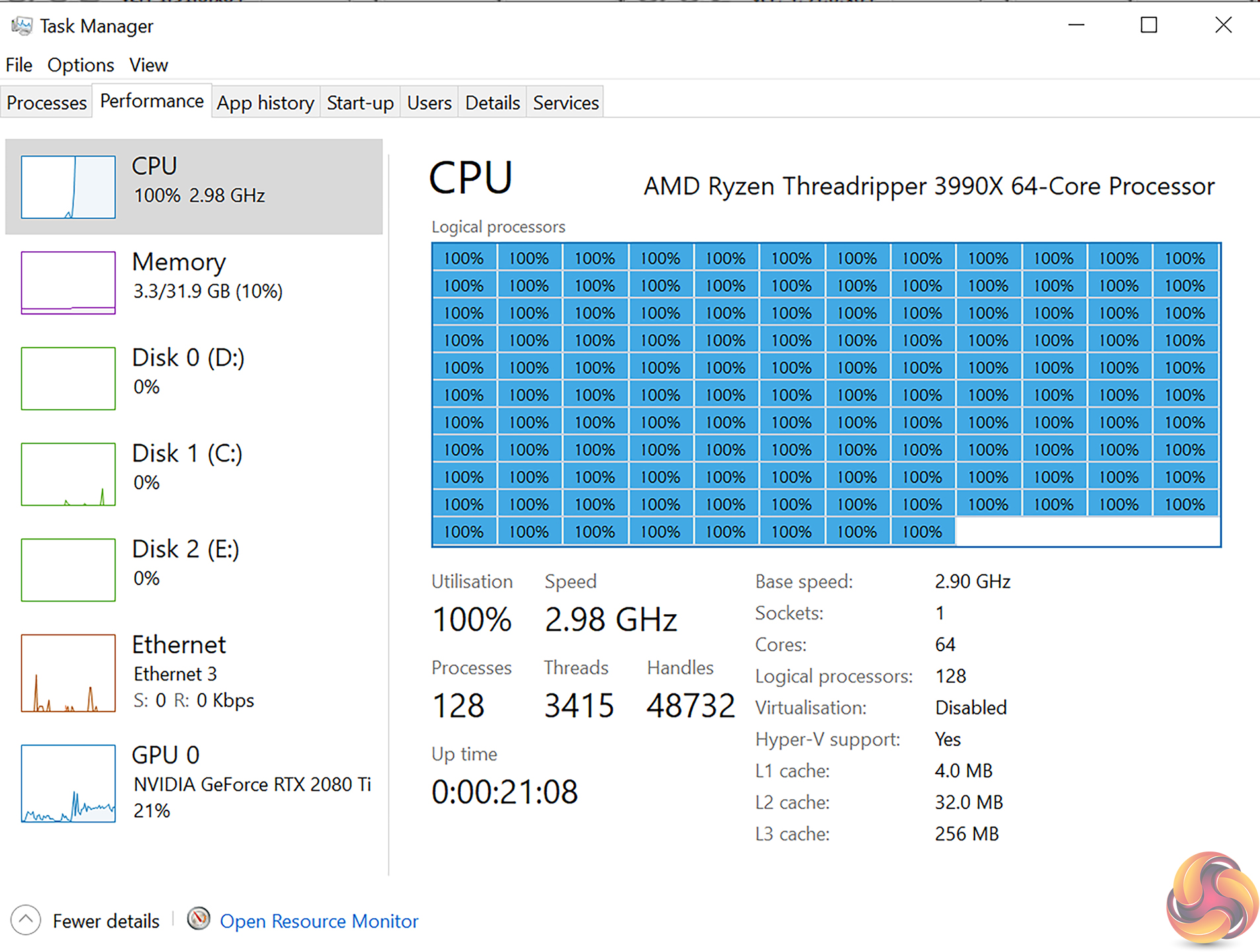

PS: This PC has 20 cores... crazy.... I have not looked but I assume thats 20 threads over 10 cores.....
