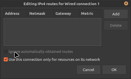

Well back on topic. It appears this has been solved for ethercat by removing the settings in /etc/network/interfaces and disabling the network that is connected to the ethercat slaves. As soon as the intercace is enabled, we loose internet connection. Ethercat is mapped at the MAC address level so it must bypass the Linux networking stack. I guess this make sense given that Ethercat uses its own protocol to maximise performance.
I'll worry about setting it up for a Mesa card another day (when I'm ready to play with one).
There still should be a way to force Linux to go out on a specific NIC so if there are ideas, let me know.

nobody yet has helped with the original problem which is specifying which NIC should be used for the default network/internet connection....

I did.
The screenshots are exactly that, set the Mesa and Ethercat connections as above, leave the Internet connection as is, do not set anything for it, it will still work properly and the traffic to Mesa and Ethercat will only be sent to Mesa and Ethercat.

15 Aug 2023 19:05 #278100
Seems to me that you keep ignoring this, so here is how you specify what NIC does what, in general, so does require a lot of reading
Ip tables.
Those are used in Linux to specify exactly what traffic gets routed where and how, but are quite a rabbit hole, so i avoided mentioning it since it is very easy to do using the GUI.
Replied by tommylight on topic Multiple Network connections (eg fo Internet and Mesa/Ethercat)
Ip tables.

Replied by rodw on topic Multiple Network connections (eg fo Internet and Mesa/Ethercat)
Tommy, I'm not ignoring anything. The PC is at work and its a public holiday today. Like you, I assumed this would be simple and used exactly your methods. Whether the fixed IP for Mesa is set up in the GUI or the intferfaces file makes no difference. Using the config file lets you set the coalescing for Intel NICs which you can't do in the GUI. This surprised me as its worked with Bookworm before.
I don't want to have this running all the time. I just wanted to work with hardware at my office desk from time to time whether its mesa or ethercat.
I think ethercat is different to a Mesa config because it does not use an IP address or interfere with other network TCP/IP comms. I have not tested but I think ethercat slaves can coexist with normal network hardware (eg. On the normal network). The only way I can get it to work is to disable the ethercat NIC in the GUI.
So yes, its a routing issue and its a long time since I've played with static routes but i've never done it with Linux. I thought it would be easy.
