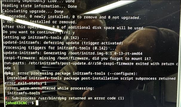

Screenshot of the error?

25 Nov 2023 18:51 #286516
Replied by rodw on topic Debian 12 - Bookworm Live installer ISO for linuxcnc (x86_64)
From the screen dump, you have nothing to upgrade so its not an issue.
That raspberry pi bug seems to have returned to Debian core code. Its not a Linuxcnc thing
SO the error is in relation to the rasppi firmware it thinks is installed.
try sudo apt remove z50-raspi-firmware or
sudo apt remove raspi-firmware if it errors

25 Nov 2023 19:42 #286518
by JohnnyCNC
Replied by JohnnyCNC on topic Debian 12 - Bookworm Live installer ISO for linuxcnc (x86_64)
That is why I downloaded the ISO again. I thought I might have grabbed the wrong one.
I tied both commands and they both error.
john@X3CNC:~$ sudo apt remove z50-raspi-firmware

I then tried this and it did not error:
john@X3CNC:~$ sudo apt purge raspi-firmware
Reading package lists... Done
Building dependency tree... Done
Reading state information... Done
The following packages will be REMOVED:
raspi-firmware*
0 upgraded, 0 newly installed, 1 to remove and 0 not upgraded.
1 not fully installed or removed.
After this operation, 0 B of additional disk space will be used.
Do you want to continue? [Y/n] y
Setting up initramfs-tools (0.142) ...
update-initramfs: deferring update (trigger activated)
(Reading database ... 161754 files and directories currently installed.)
Purging configuration files for raspi-firmware (1.20220830+ds-1) ...
Processing triggers for initramfs-tools (0.142) ...
update-initramfs: Generating /boot/initrd.img-6.1.0-13-rt-amd64
That seemed to do it.
Thanks Rod.

/etc/kernel/postinst.d/dkms:
dkms: running auto installation service for kernel 6.1.0-15-rt-amd64.
dkms: autoinstall for kernel: 6.1.0-15-rt-amd64.
/etc/kernel/postinst.d/initramfs-tools:
update-initramfs: Generating /boot/initrd.img-6.1.0-15-rt-amd64
raspi-firmware: missing /boot/firmware, did you forget to mount it?
run-parts: /etc/initramfs/post-update.d//z50-raspi-firmware exited with return code 1
run-parts: /etc/kernel/postinst.d/initramfs-tools exited with return code 1
dpkg: error processing package linux-image-6.1.0-15-rt-amd64 (--configure):
installed linux-image-6.1.0-15-rt-amd64 package post-installation script subprocess returned error exit status 1
dpkg: dependency problems prevent configuration of linux-image-rt-amd64:
linux-image-rt-amd64 depends on linux-image-6.1.0-15-rt-amd64 (= 6.1.66-1); however:
Package linux-image-6.1.0-15-rt-amd64 is not configured yet.
dpkg: error processing package linux-image-rt-amd64 (--configure):
dependency problems - leaving unconfigured
Errors were encountered while processing:
E: Sub-process /usr/bin/dpkg returned an error code (1)

I don't understand why this is happening. Is it a new installation?
Why has dkms been loaded? do you have any drivers (eg realtek NIC drivers) installed that requires it?

Still the old image with raspi issues????
forum.linuxcnc.org/39-pncconf/50179-a-li...zard?start=30#281934
Replied by tommylight on topic Debian 12 - Bookworm Live installer ISO for linuxcnc (x86_64)
