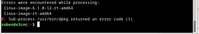

I meant to say I probably deserved that Tommy...but you use what you know, right? I'm just an old guy that still remembers 8" floppies!!

Its hard to say without seeing the context.
I had the same problem recently on a Debian desktop PC. I had been giving it a hard time with an ARM64 cross compiler.
I could not resolve it so reinstalled Debian (using the same installer as used here)
Note this is a clone of the existing Linuxcnc installer and some stuff was preexisting so not my work!

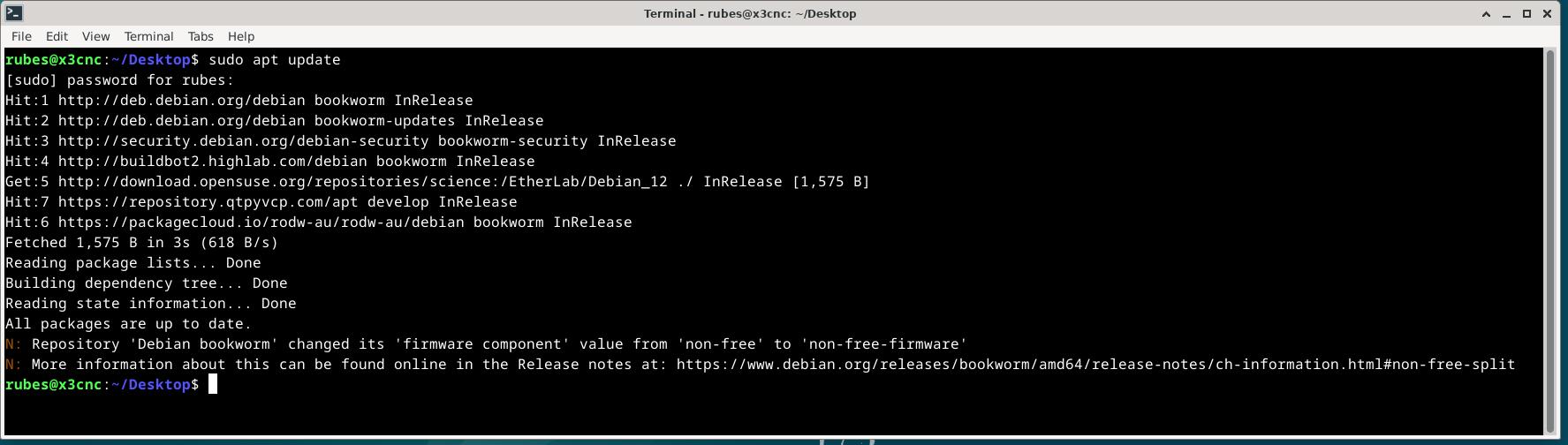

- rubes
- Posts: 45
18 Sep 2023 14:08 #281099
by rubes
Replied by rubes on topic Debian 12 - Bookworm Live installer ISO for linuxcnc (x86_64)
although I no longer need this because I used the process tommylight showed in another thread and it worked perfectly (including the access to the mirror site)...I figured I'd give it a go since I have several days invested already.
this worked much better for me.
sudo apt update shows all packages up to date. Still shows that one repository has changed a value? but seemed to work fine.
I also did the python and probe basic installs and they completed without any errors.
BUT...there is always a butt(and sometimes I feel like its me
,,,I cant get any configs to load...not even the sims.
attached below is the log I get when I try to load the axis sim.
and if I try to load a qtdragon sim;
This is just FYI, as I have a working system from other methods.

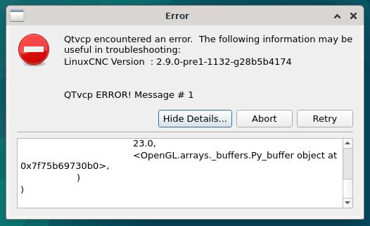

- Posts: 12172
- Thank you received: 4154
18 Sep 2023 15:27 #281103
Replied by rodw on topic Debian 12 - Bookworm Live installer ISO for linuxcnc (x86_64)
Thanks for the feedback. I've been sleeping! If you could you doand share the output.
We should see non-free non-free-firmware on the lines starting with deb
I don't think the message about non-free-firmware is any concern, but that output will confirm
Re the QTVCP error, That has been reported several times recently on the forum, It could just be a missing dependency. Hopefully somebody will advise.
cat /etc/apt/sources.listWe should see non-free non-free-firmware on the lines starting with deb

From another thread, please run
and try again.
I will try tonight
sudo apt install libgl1-mesa-glx libgl1-mesa-dri xserver-xorg-coreand try again.
I will try tonight
