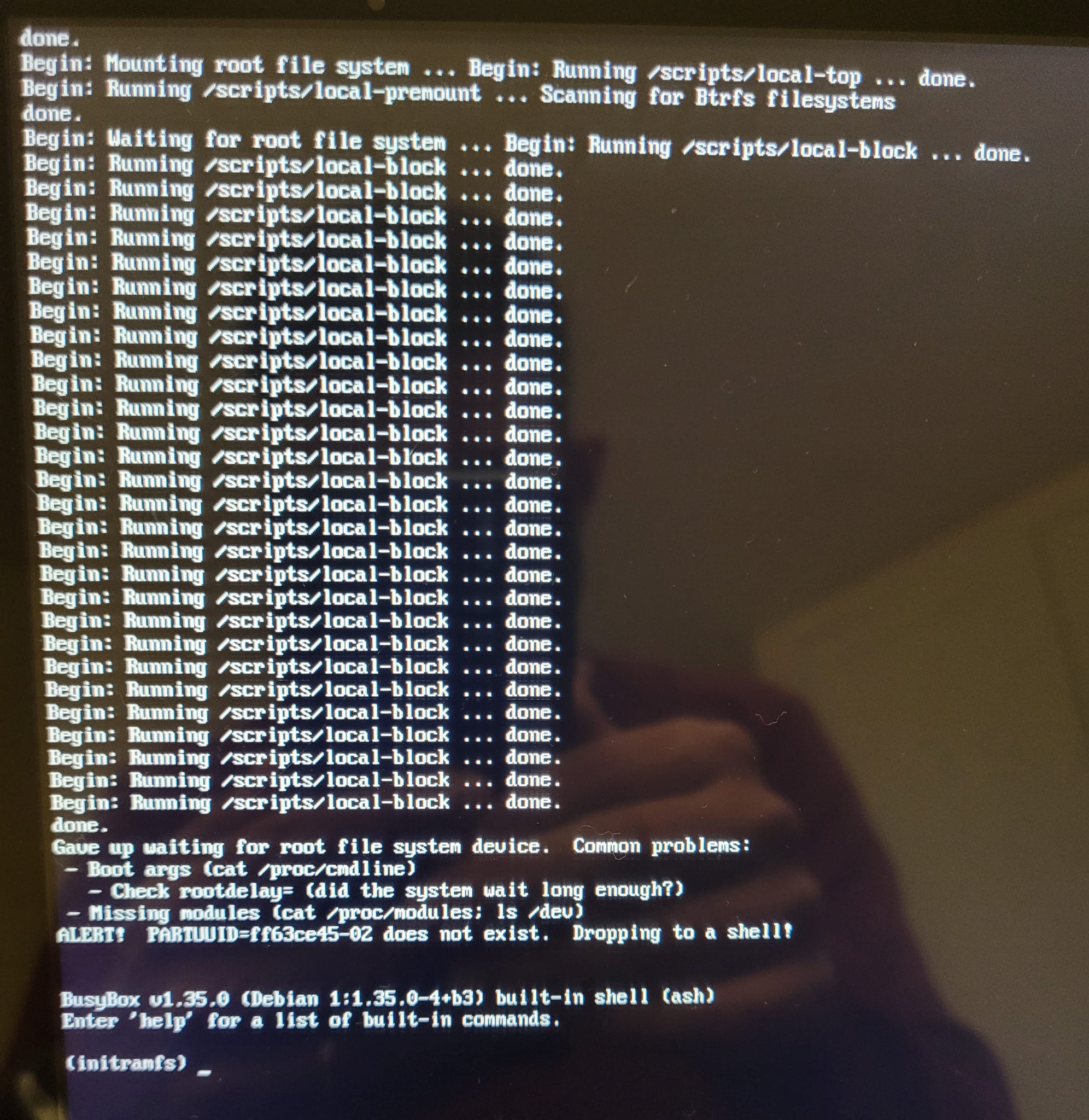

12 Nov 2023 04:30 #285154 by danielfmo
Replied by danielfmo on topic LinuxCNC on Raspberry Pi 5
Tried your branch (thanks for the work BTW)
Though the rpi5 does not boot, I'd guess the first boot script needs some magic, but I'm not familiar yet with the project to understand what is not working.
I have a rpi5 dedicated for a linuxCNC test bench, so I's love to be able to perform some testing if someone has the time to take a look at this.

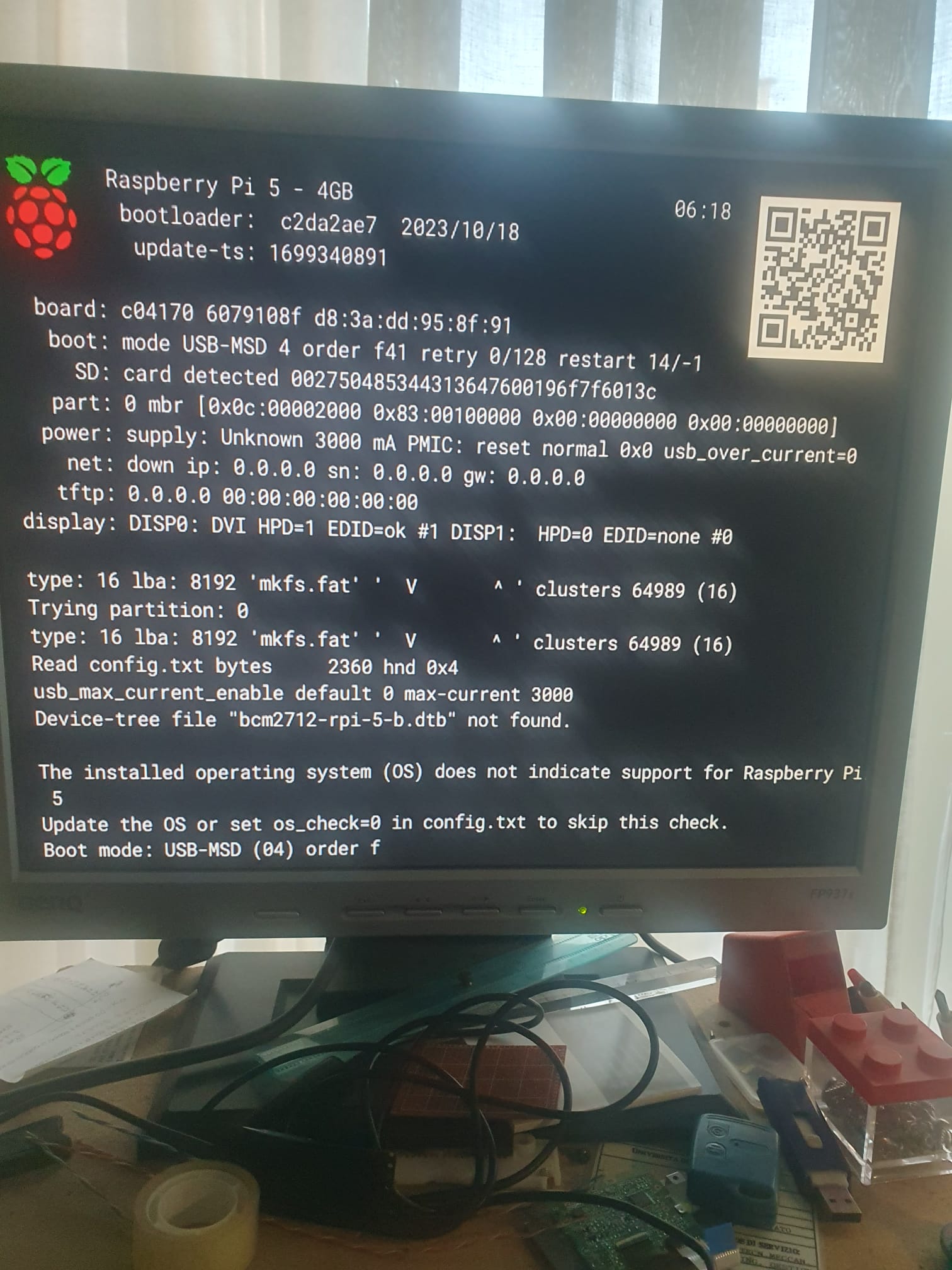

13 Nov 2023 03:21 #285244 by elovalvo
Replied by elovalvo on topic LinuxCNC on Raspberry Pi 5
14 Nov 2023 06:07 #285371 by rodw
Replied by rodw on topic LinuxCNC on Raspberry Pi 5
Are you uing the img from the Linuxcnc downloads page? That is now the best image
14 Nov 2023 09:17 #285385 by elovalvo
The image in linuxcnc.org/iso/linuxcnc-2.9.1-bookworm-rpi4.img.xz does not work with the Raspberry Pi 5
14 Nov 2023 12:07 #285403 by rodw
Damn, they said nobody would have one untill after Christmas!
Hopefully its just a matter of changing the board to build for the pi5 when building the image as shown here
github.com/rodw-au/rpi-img-builder-lcnc/...-2.9.1/build-lcnc.sh
It may just need to be set to BCM2712 Ref: www.raspberrypi.com/products/raspberry-pi-5/
I will check in with upstream.

16 Nov 2023 06:08 - 16 Nov 2023 06:11 #285608 by danielfmo
that is what I tried to point out in my previous message: forum.linuxcnc.org/9-installing-linuxcnc...pi-5?start=10#285154
Setting the board to BCM2712 does not work and the RPI5 gets into a "running /scripts/local/block" loop
As an additional note, there's this also written in the PREENPT_RT release page (github.com/kdoren/linux/releases/tag/rpi_6.1.54-rt15)
NOTE: The installation instructions in the wiki work for debian bullseye, and currently require changes for debian bookworm. Bookworm (like Ubuntu) expects the files to be copied into directory
/boot/firmware/
 instead of
/boot/
