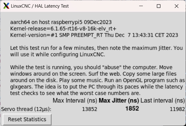

isolcpus 2.3
Max latency during a short test was about 15us
I hooked it up to a MESA 7i76s and just worked. So no network latency issues (yet).
I'll let it run for a while.
The 640x480 display limit is a bugger. Any idea how to fix that?
It does run pretty warm.
Processor utilization running gcode in Axis is around 15% for cores 1 and 2

I prepared a new image for the Raspberry Pi5
Linux raspberrypi5 6.1.65-rt16-v8-16k-elv_rt+ #1 SMP PREEMPT_RT Thu Dec 7 13:43:31 CET 2023 aarch64
in which I installed a version of linuxcnc_2.10.0~pre0_arm64
forum.linuxcnc.org/9-installing-linuxcnc...xcnc?start=20#287208
This image can be downloaded from here
drive.google.com/file/d/16kKamxMKPdYAeJp...KLf/view?usp=sharing
At first glance everything seems to work regularly and the lowest value that did not show the "Unexpected realtime delay" message was
latency-test 12000
The values ​​are much better than the version here:
forum.linuxcnc.org/9-installing-linuxcnc...-pi-5?start=0#285243

Why are you running such a low servo thread ?
If you are running Wayland just be wary that any apps that make calls to X lib functions will be a little, ahem, slow.
