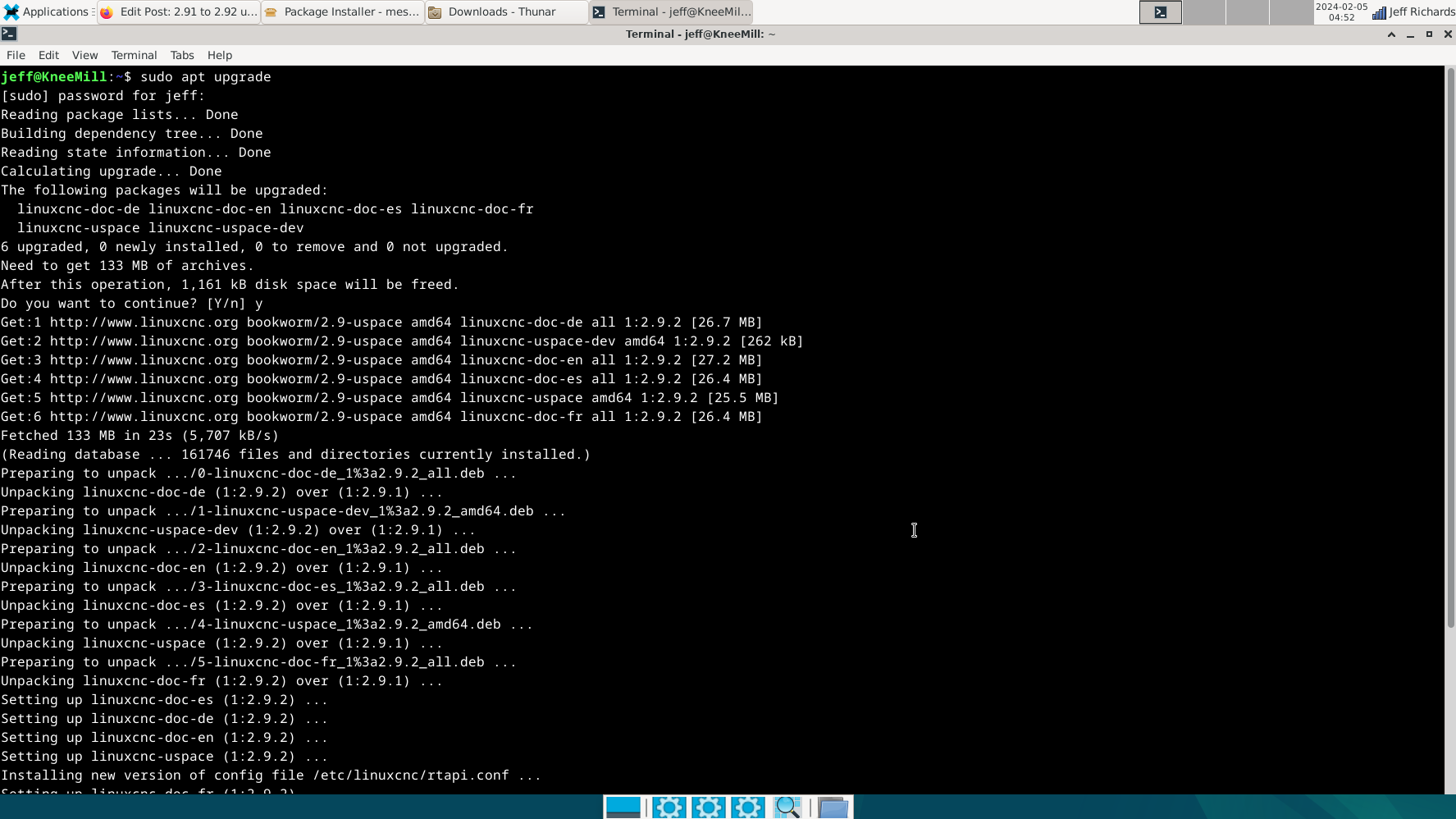

05 Feb 2024 07:11 #292508
Replied by tommylight on topic 2.91 to 2.92 upgrade
MesaCT is a separate project by JT, so it should work on it's own and it does not care about LinuxCNC versions.
You might need to upgrade MesaFlash to recognize the 7i95T, try
sudo apt update
sudo apt upgrade
And check the terminal if it upgraded MesaFlash.
sudo apt update
sudo apt upgrade

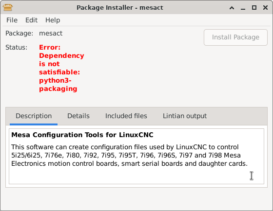

05 Feb 2024 07:20 - 05 Feb 2024 07:44 #292509
by slowpoke
Replied by slowpoke on topic 2.91 to 2.92 upgrade
I'm not sure how to interpret this.....
After that I did upgrade and it seemed to work...
However the 7i95t still does not appear when I run pcconf.
When I right click mesact_2.2.2_amd64.deb I get the following error.
Leading me to think that installing v2.92 (because my understanding is that v2.92 includes the Java code that I seem to be missing) will allow me to get the 7195t into pcconf?
Last edit: 05 Feb 2024 07:44 by slowpoke.

05 Feb 2024 08:14 #292515
Sudo apt install python3-packaging

05 Feb 2024 08:50 #292520
by slowpoke
I get
E: Unable to locate package python3-packaging

05 Feb 2024 08:55 #292522

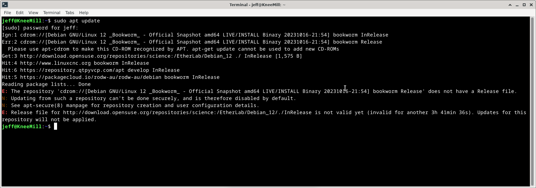

- Posts: 12172
- Thank you received: 4154
05 Feb 2024 13:53 #292563
Replied by rodw on topic 2.91 to 2.92 upgrade
You did not connect to the internet while installing.
Replace your sources list with
with
sudo geany /etc/apt/sources.list
then
sudo apt update
sudo apt upgrade
Ref: wiki.debian.org/SourcesList
deb http://deb.debian.org/debian bookworm main non-free-firmware non-free
deb-src http://deb.debian.org/debian bookworm main non-free-firmware non-free
deb http://deb.debian.org/debian-security/ bookworm-security main non-free-firmware non-free
deb-src http://deb.debian.org/debian-security/ bookworm-security main non-free-firmware non-free
deb http://deb.debian.org/debian bookworm-updates main non-free-firmware non-free
deb-src http://deb.debian.org/debian bookworm-updates main non-free-firmware non-freesudo geany /etc/apt/sources.list
then
sudo apt update
sudo apt upgrade
