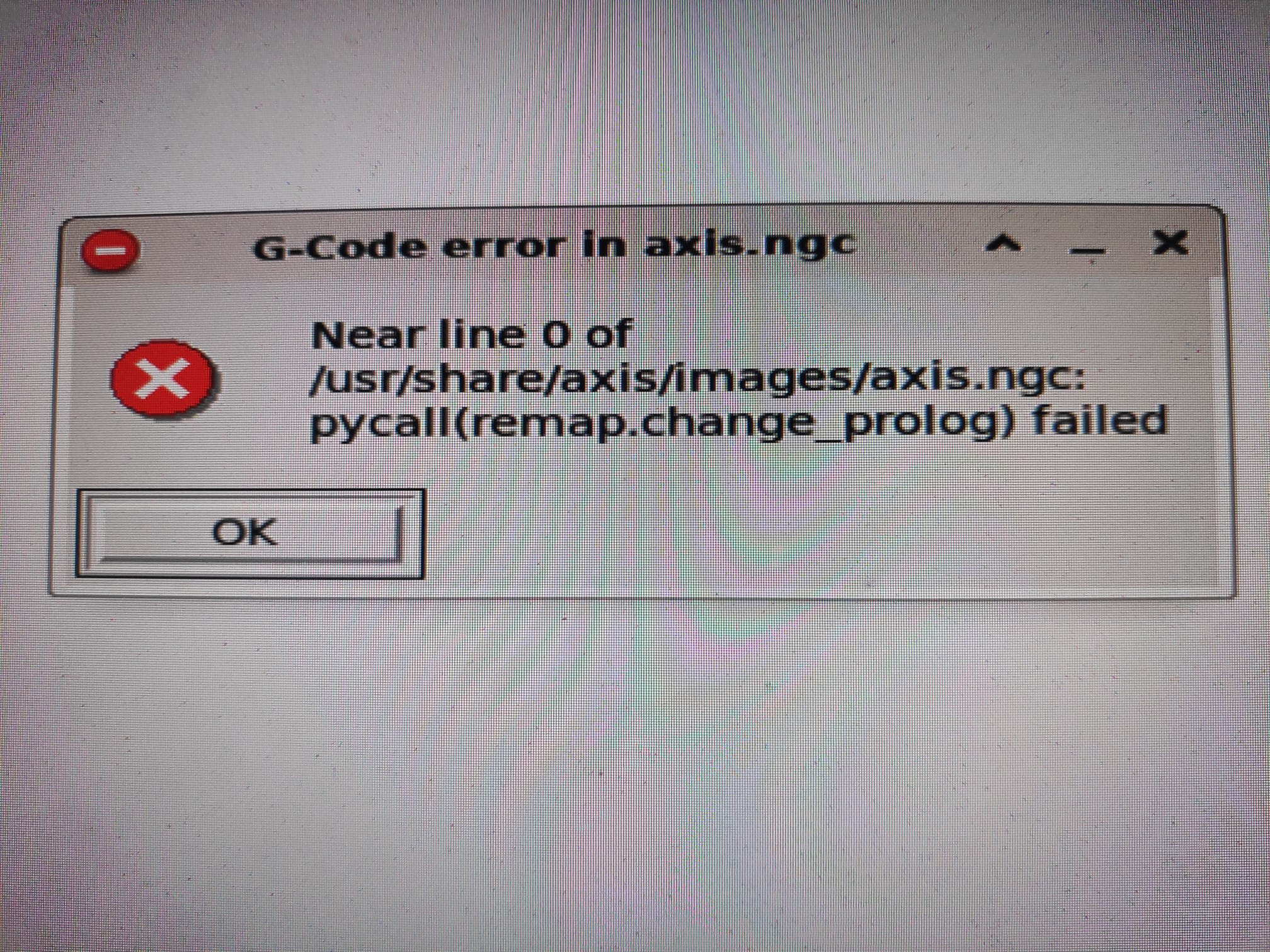

Hello,
After installing LinuxCNC 2.9.2 Debian 12 Bookworm PREEMPT-RT ISO can't use rack tool change (works ok with linuxMint with linuxcnc 2.9.0)
My config don't work and SIM RackToolchange don't work.
What can be the problem?
Best Regards,
Marco Gaspar

initialize: module '/home/mjg/linuxcnc/configs/MJG_CNC/python/toplevel.py' init failed:
File "/home/mjg/linuxcnc/configs/MJG_CNC/python/toplevel.py", line 1, in <module>
import remap
File "/home/mjg/linuxcnc/configs/MJG_CNC/./python/remap.py", line 1, in <module>
from stdglue import *
ImportError: bad magic number in 'stdglue': b'\x03\xf3\r\n'
I think this can be caused by incompatible .pyc files so I would delete all the files with .pyc extension in your config folder and try again.

11 Feb 2024 20:30 #293107 by MarcoGaspar
Replied by MarcoGaspar on topic linuxcnc2.9.2 RackTool Change
After copying the files on the simRacktoolchange to my config folder i get "pycall(remap.change_prolog) failed"
