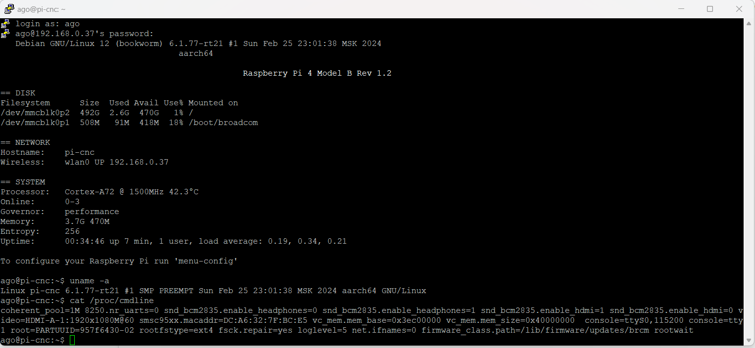

Got it via balenaEtcher!
Thanks guys!
I still to customize it's vnc-server as I use headless CNC and install LinuxCNC itself. I didn't find it in the installed programs...
Will dig your framework deeper how to customize adding of the additional sources and gpg keys (to have linuxcnc, vscode, and sublime on the board).
Again - great work - The building process took about 30 minutes on 16 cores!
Thanks guys!
ago@pi-cnc:~$ uname -a
Linux pi-cnc 6.1.77-rt21 #1 SMP PREEMPT Sun Feb 25 23:01:38 MSK 2024 aarch64 GNU/LinuxI still to customize it's vnc-server as I use headless CNC and install LinuxCNC itself. I didn't find it in the installed programs...

Hello guys, I continue experiments with just created image.
I have burned it on the SD Card 512Gb (not sure, probably it is to much?)
Did you faced with troubles like read-only root file system?
Here is what I have checked:
ago@pi-cnc:~$ sudo mount | grep /dev
udev on /dev type devtmpfs (rw,nosuid,relatime,size=1667364k,nr_inodes=416841,mode=755)
devpts on /dev/pts type devpts (rw,nosuid,noexec,relatime,gid=5,mode=620,ptmxmode=000)
/dev/mmcblk0p2 on / type ext4 (ro,noatime,errors=remount-ro,commit=600)
tmpfs on /dev/shm type tmpfs (rw,nosuid,nodev)
mqueue on /dev/mqueue type mqueue (rw,nosuid,nodev,noexec,relatime)
/dev/mmcblk0p1 on /boot/broadcom type vfat (rw,relatime,fmask=0022,dmask=0022,codepage=437,iocharset=ascii,shortname=mixed,flush,errors=remount-ro)

- About the SD Card and I decided to think that it was some troubles with SD partition and just taken another one, if it will be reproduced - I'll dig it deeper.
- I understand the idea of selecting kernel-and-patch consistency, in my actual test I try to take fresh kernel 6.1.77 and corresponding RT patch 77-rt24.
I also excited about the way of installing additional packages from standard Debian sources as well as from additional using userscripts.
rodw, I also would suggest a small fix to support the spaces in full name, otherwise someone will receive something like that (example for full name "Andrey CNC"):
+ adduser ago --gecos Andrey CNC --disabled-password
adduser: The user `ago' does not exist.
As I understand it is placed in two places:
* github.com/rodw-au/rpi-img-builder-lcnc/...ccount#L12C29-L12C36
* github.com/rodw-au/rpi-img-builder-lcnc/.../scripts/stage2#L112
(Not sure about the correct fix, I am not very experienced with bash yet. I tried to fix it with '${NAME}' but just received name ${NAME}
I am very excited to the way you did this image builder!
cornholio, you said that you did something similar to my experiment with the original Raspberry Pi OS image. I slightly confused with my tutorial at the early beginning of this thread. Nevertheless I did it once, I can not repeat it anymore... Not sure what the problem is, unfortunately screen shows very fast several red lines in the console during the boot and then I see the only black screen. Did you posted your steps somewhere? I I will be very pleased if you could briefly take a look at my solution and find problems there if any.
