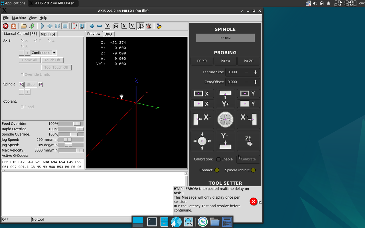

Well snap, jealous of those which .279 works. Doesn't seem to like my lenovo & 4ax milling machine for some reason
Reverting back to 5.4.258 sorts it in my case.
Observations:
1. Upgrade from .258 -> .279 went smooth. RTAI starts and everything. (That's all good).
2. The isocpu grub init is indeed mandatory. Does not start otherwise. (I personally don't care!)
3. On a PC cold boot I can; start linuxcnc, home the machine, jog. (That's all good).
4. I do however get a new RTAPI ERROR. I didn't had this with 5.4.258. (see visual).
5. If I close linuxcnc, it's impossible to start it up again. Needs a full machine reboot. (see attached logs/traces).

Hey Mecanix, are you able to start and close the latency histogram without rebooting? If not, try a more simple test. The RTAI testsuite is built-in and you can try running that as well.
It's: /usr/realtime*/testsuite/run (Ctrl+C to cancel)

Good and bad news. Bad news first; I've put back 5.4.258 temporarily. I really terrorized myself yesterday when I saw it broken (sweats man lol), knowing I desperately need this mill all of this coming Saturday and Sunday (important project). And so the bad news is I won't be able to test this out, at least not before the coming week.
The good news is; I'll surely reinstall 5.4.279 and give it another go. Let's get to the bottom of this, if not only to improve the making of RTAI. I'll update in 4~5 days max.
Side note. I've just placed a Dell Optiplex 780 w/ a built-in parport on order to backup with. That way I can test on real hardware before making changes to the production-ready kit - yesterday's self-terrorism just can't happen again.

To begin with I have no idea how to clean a previous RTAI installation (if required?), or whether it's okay to simply "upgrade over" which is what I've done.
Additionally (less inspiring!). I've completed a clean Debian 12 install on my newly acquired Dell Optiplex. All updated, all drivers functional, no errors, everything's happy. Then proceeded to installing the RTAI 5.4.279 debs (module, headers, image, then lcnc), to have nothing showing up when starting linuxcnc. It reports that module is not loaded, although re-installed the deb twice now
Not entirely sure what I've done to RTAI to deserve all that, we used to be good friends!!
Replied by Mecanix on topic New and Working RTAI debs for 2.9
Hi NTULINUX. I have no doubt in that statement, doubting my knowledge/skillset is in upgrading linux systems rather. Mind you I was able to use the 5.4.279 release full featured. Only bug was a new timeout error on starting, and ofc not being able to restart lcnc if closed - a full system reboot was required.if anything it should be better and not worse, and this is a run-on-sentence.
