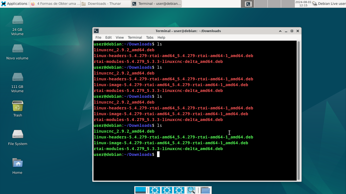

As far as I understand, I have already downloaded the files but what commands should I use to install?
- Posts: 1200
- Thank you received: 426
01 Aug 2024 08:13 #306609
Replied by Cant do this anymore bye all on topic help with installation
forum.linuxcnc.org/9-installing-linuxcnc...r-2-9?start=0#304599
Start with the kernel packages, then I think there are some modules then finally the Linuxcnc packages. Best thing is to read completely read through both threads linked in the previous threads.

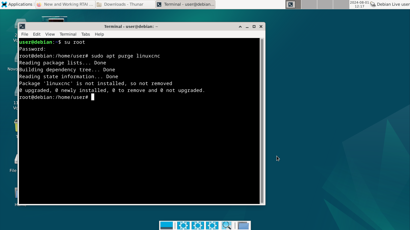

01 Aug 2024 09:14 - 01 Aug 2024 09:15 #306622
by cnbbom
Replied by cnbbom on topic help with installation
apt purge linuxcnc*
Reading package lists... Done
Building dependency tree... Done
Reading status information... Done
The package 'linuxcnc' is not installed, so it will not be removed
0 packages upgraded, 0 newly installed, 0 to be removed, 0 not upgraded.
Last edit: 01 Aug 2024 09:15 by cnbbom.

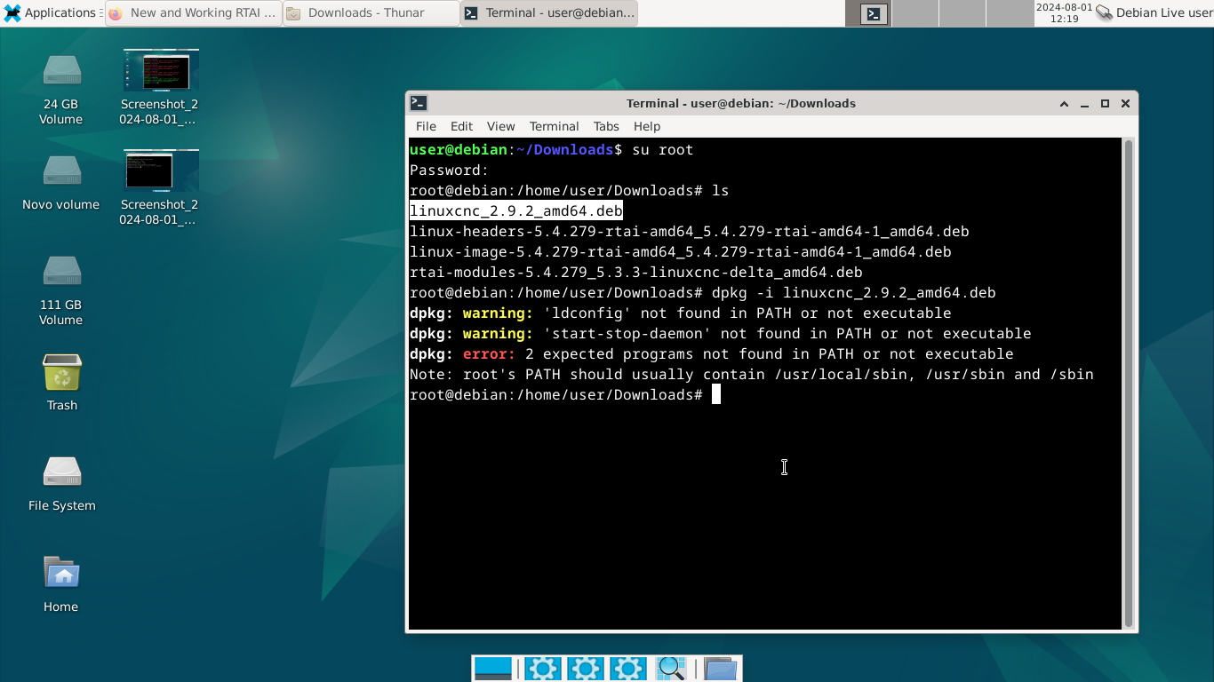

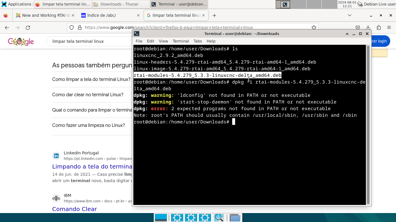

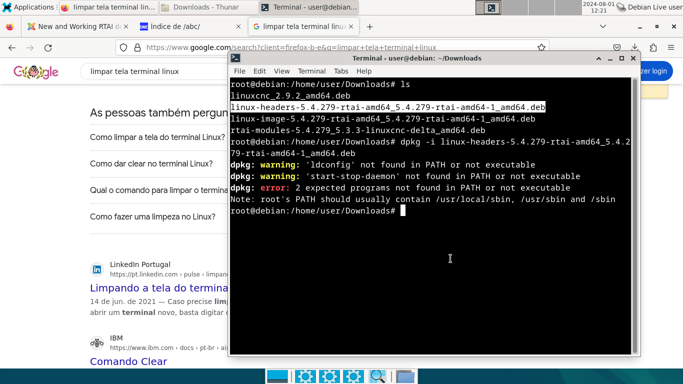

01 Aug 2024 10:32 #306627
by cnbbom
I can now say what condition I am in
- Posts: 22030
- Thank you received: 7504
01 Aug 2024 10:48 #306631
Replied by tommylight on topic help with installation
Do a new full install and start over.
Never use root or SU to install stuff as everything will be installed in the root folder and nothing will work as a normal user, always use sudo.
LinuxCNC will refuse to run as root due to having full hardware control and stopping misuse.

01 Aug 2024 11:15 #306635
by cnbbom
Before seeing your post, that's what I did, so I was right to do a new installation
Thank you, now I need to know something, are there 4 files, should you install all 4 or just one?
linux-headers-5.4.279-rtai-amd64_5.4.279-rtai-amd64-1_amd64.deb
Arquivolinux-image-5.4.279-rtai-amd64_5.4.279-rtai-amd64-1_amd64.deb
Arquivolinuxcnc_2.9.2_amd64.deb
Arquivortai-modules-5.4.279_5.3.3-linuxcnc-delta_amd64.deb
