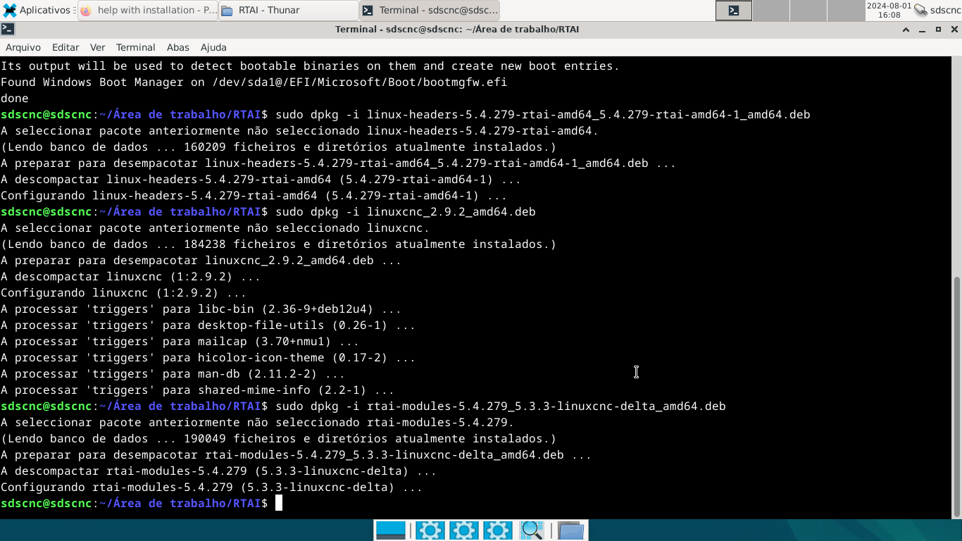

Replied by tommylight on topic help with installation
1 linux image
2 linux headers
3 linuxcnc
4 rtai modules
OR
3 rtai modules
4 linuxcnc
Gdebi will tell you if there is something that needs to be installed.
2 linux headers
3 linuxcnc
4 rtai modules
OR
3 rtai modules
4 linuxcnc

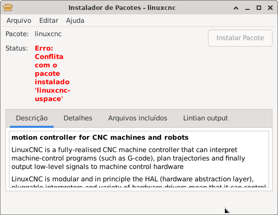

following the steps indicated, it says that I must uninstall any traces of Linux, but I receive the following message.
To install on Debian 12 with linuxcnc-uspace already installed use : sudo apt purge linuxcnc* and wait for apt to completely remove every trace of LCNC.
but it happens this way
- cnbbom
- Posts: 47
- Thank you received: 5
01 Aug 2024 11:46 #306639
by cnbbom
Replied by cnbbom on topic help with installation
this says it is conflicting
- Posts: 22030
- Thank you received: 7504
01 Aug 2024 13:17 #306649
sudo apt purge linuxcnc-uspace linuxcnc-uspace-dev

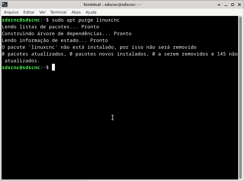

01 Aug 2024 14:12 #306655
by cnbbom
ok, I got this screen, I didn't do any more procedures here. What to do now? restart linux or is there any other procedure?

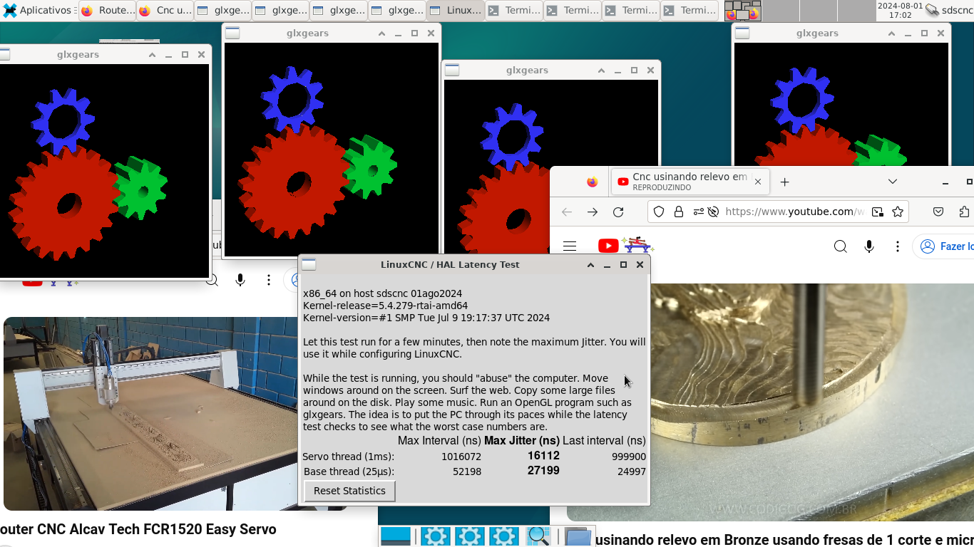

01 Aug 2024 14:40 #306659
Reboot
hold down the SHIFT key till you see the GRUB menu, choose the line with RTAI in the name and press enter
run LinuxCNC
run LinuxCNC

jitter stabilized at 32000, if I adopt these values and my driver's resolution is 800, what reliable speed can I explore with the machine?
- Posts: 22030
01 Aug 2024 16:01 #306675
I would skip that for now, make the machine move first, later when you are happy that it works, you can punish yourself with some fine tuning!
Set the base period to 100000 at first (write 60000 in the jitter value in StepConf wizard), see if you get latency warnings when running LinuxCNC, and if you do not, then you can lower that value in 10000 increments.

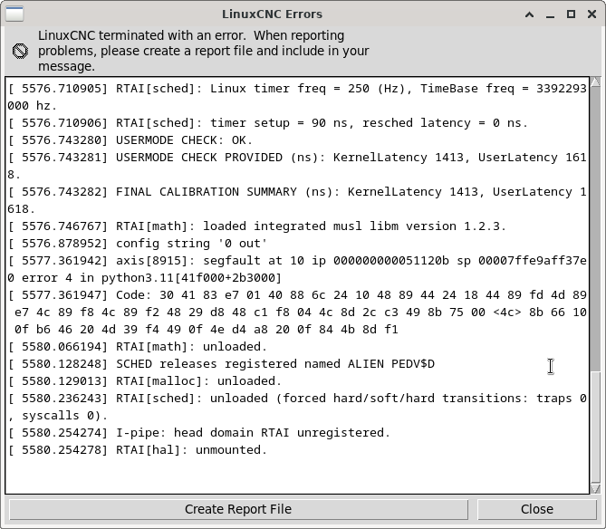

01 Aug 2024 16:17 #306676
by cnbbom
I hadn't opened it yet but I got this message on the screen
