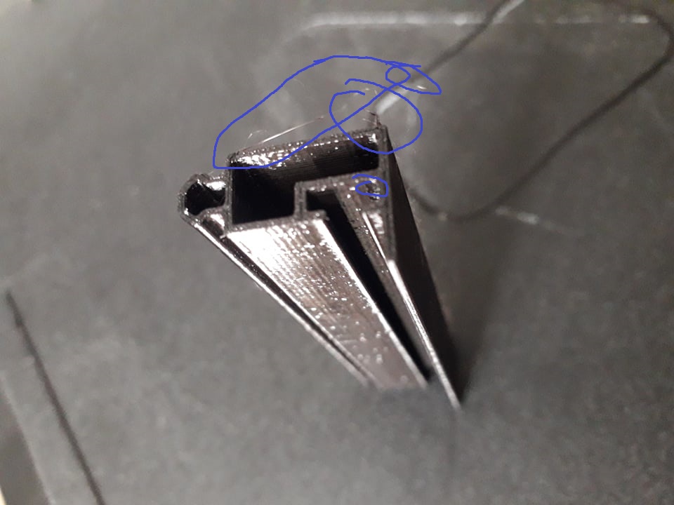

Some pictures would help, but since i know you have Creality CR-10S PRO V2, it comes with an aluminium bed so i would not use anything above 40C for the bed with big stuff and 45 for small stuff, big stuff is very hard to get off of it, it sticks to damn good to it!
As for hotend temps, i use 210 to 215 for standard speeds and 220-235 for 0.8mm nozzle and fast prints with thick lines when a lot of filament has to get melted.
As a side note, today i had my first nozzle plug on the Ender 5 Plus, took 2 hours to figure out and tear the hotend apart, get the PTFE tube out after removing all the fans and being careful not to mess up the BL Touch, heating and cooling several times, etc etc. Damn that PTFE tube is slippery!

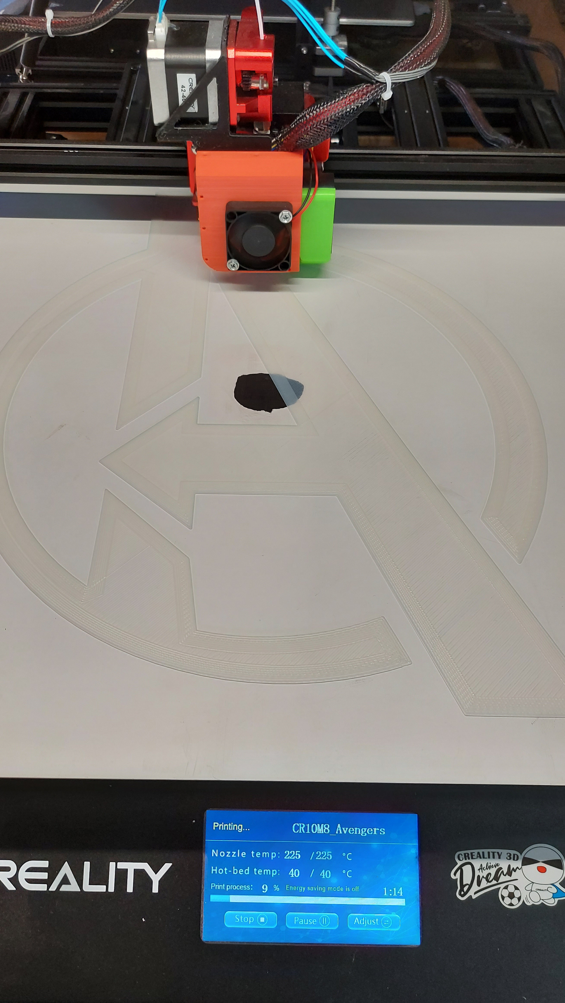

That is on Creality CR-10 MAX latest version modified to direct extruder with 0.8mm nozzle and 1mm width, 0.32mm layer height.
Never mind the bed it got ruined by printing everything at the centre, it is cheap magnetic stuff at 10 Euro/meter and 60m width, enough for the Max and when changing it only the top needs to be replaced making it 5 Euro! PLA and PLA+ stick to it even without heating except very small parts.
Replied by tommylight on topic Some 3D printing advice to start this section
