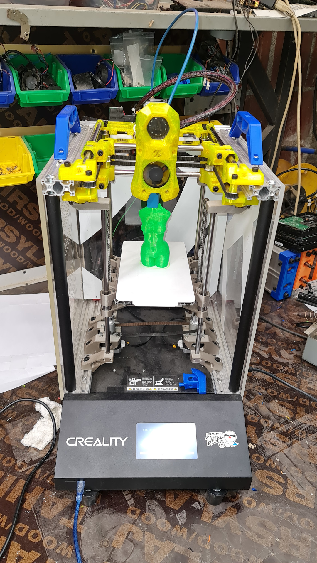

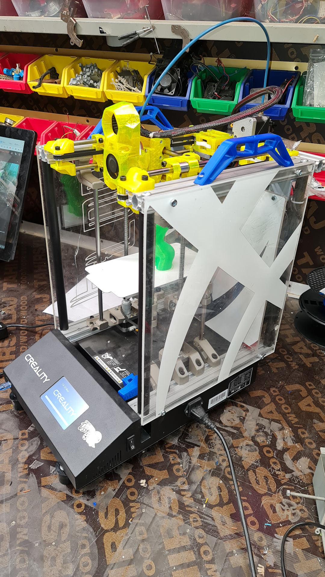

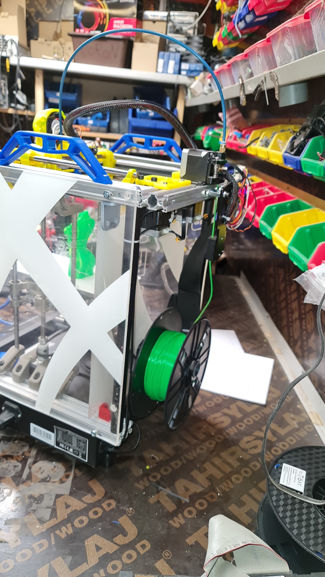

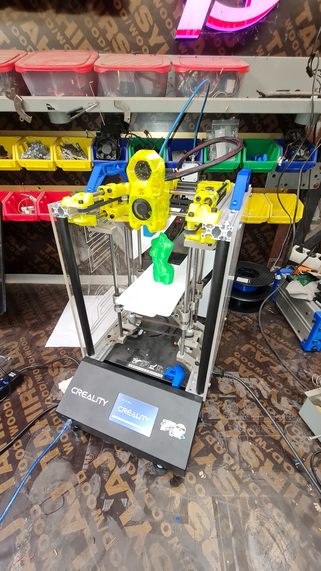

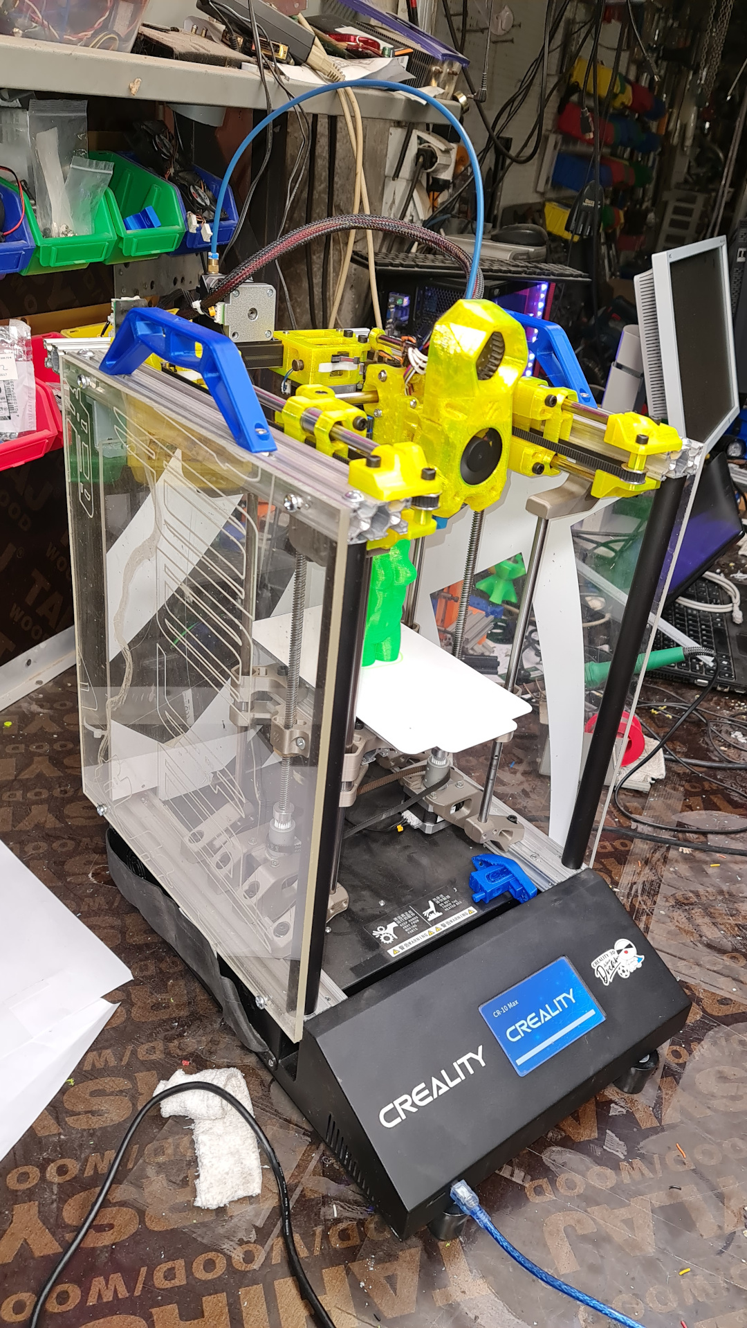

Here is another of my monstrosities, a Voron Legacy mounted on the Creality CR-10 MAX control box.
Original Creality board with silent drives, BL-Touch, AfterBurner with a Volcano hot end, double Z, etc.
Also attaching the config for it, someone on youtube requested it, remove the .txt after download.
