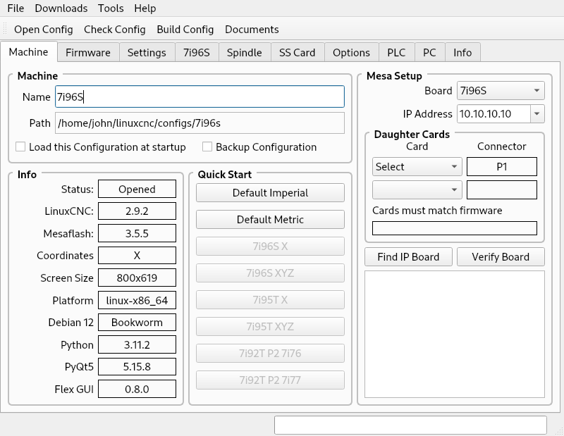

The Mesa Configuration Tool is here:
gnipsel.com/linuxcnc/mesact/index.html
With this tool you can read and flash a Mesa board, build your configuration files with no preset machine types.
If you just have an A axis Mesa CT will build that.
If you encounter an error use the issue tracker if you can or report it here.

Hi JT,
I just did a fresh install of linuxCNC 2.9.3 and MesaCT 2.1.4.
Things that I notice & happen-
When I run the software the info panel reports LinuxCNC version 2.9.0 not 2.9.3
1. I enter the machine name and check load this config & backup config.
2. When I press default Metric for the linear units, the info in 1. above disappears. In fact if I enter the Mesa setup, verify the board then press Default metric all that information disappears as well. Is this normal behavior for the software?
Also noticed step 3 in your help "Select Max Linear Velocity" does not exist on the Machine tab but it does on the Settings tab.

Yes, the "default" buttons will create a new blank configuration and then populate some units and a few variables, mostly I used them for testing. Perhaps a different function would be better. If you have any ideas let me know.
JT
Replied by JT on topic Mesa Configuration Tool
What does apt-cache policy linuxcnc-uspace in a terminal return?Hi JT,
Code:
def default_metric(parent):
utilities.new_config(parent)
parent.linearUnitsCB.setCurrentIndex(parent.linearUnitsCB.findData('mm'))
default(parent)
JT

I just pushed a fix for getting the LinuxCNC version so download and reinstall the deb.
JT
