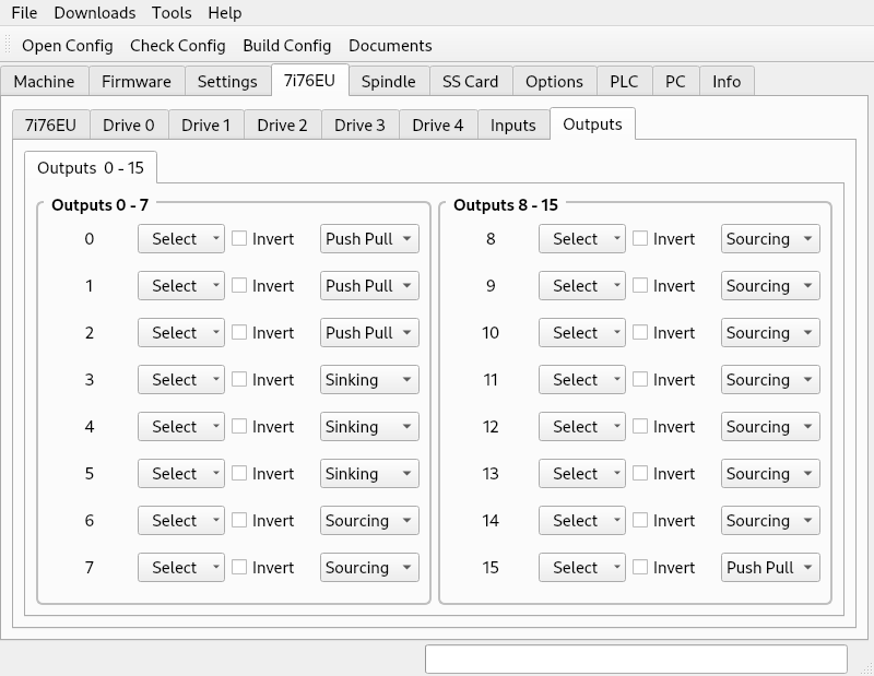

22 Feb 2025 06:47 #322271
by JT
Replied by JT on topic Mesa Configuration Tool
- Posts: 18122
- Thank you received: 5337
22 Feb 2025 11:57 #322286
Replied by PCW on topic Mesa Configuration Tool
Looks great!

Another remark.. not sure if that me misunderstanding anything or if its another bug, but witih MesaCT I generated a config to set my outputs 0-7 to sinking and 8-15 to sourcing.
This were the generated lines:
setp hm2_7i76e.0.7i76.0.0.output_sink 0xff00
setp hm2_7i76e.0.7i76.0.0.output_source 0xff
isnt this "the wrong order"? imho this sets 0-7 to source and 8-15 to sink.. right?
Last edit: 29 Jun 2025 11:14 by SebastianM.
- JT
- Posts: 1123
- Thank you received: 616
29 Jun 2025 11:37 #331010
by JT
I was generating the bit string backwards which only worked right if all output types were the same. I just fixed that with PCW's help. The inputs and outputs hal has just been fixed as well.
JT
JT
The following user(s) said Thank You: SebastianM
