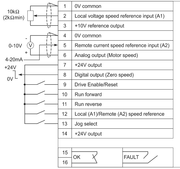

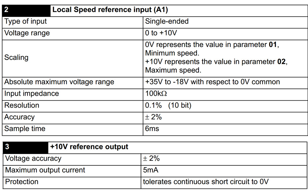

- tommy
- Posts: 106
- Thank you received: 3
29 Nov 2024 01:30 #315516
by tommy
Replied by tommy on topic Mesa Configuration Tool
- Posts: 22042
- Thank you received: 7506
29 Nov 2024 04:41 #315523
Replied by tommylight on topic Mesa Configuration Tool
A1 goes to AOUT (or spindle out) on Mesa.
