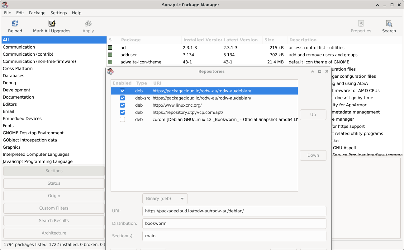

- gbsd86
- Posts: 14
07 Jan 2025 20:28 #318345
by gbsd86
Replied by gbsd86 on topic Mesact 2 Setup
I checked OS version (see below). Is Debian 12 Bookworm.
Using Gdebi, installation fails because of python3-distro.
Synaptic search doesn't show python3-distro. Also not in the list of python3 files.
Have the zip file of python3-distro. Haven't been able to figure out how to install it.

- gbsd86
- Posts: 14
07 Jan 2025 20:53 #318351
by gbsd86
Synaptic repositories
- JT
- Posts: 1095
- Thank you received: 583
07 Jan 2025 20:57 #318352
by JT
JT
Replied by JT on topic Mesact 2 Setup
OK your using Rod's OS and he prob deleted it the scoundrel LOLSynaptic repositories
JT
