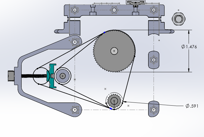

I changed the number to in the driver gui to 1800 and upped the 'stepsPerRev' variable in the Arduino code to 600 and its working great so far. This is with the dip switches set at default.
If i switch the dip switches to 1600, the value in the gui updates to 1600. So this leads me to believe the dip switches set the steps per revolution. in retrospect i guess its obvious.
I am going to leave it as is because its clean and now going to switch the control to closed and see about tuning in the PID before i reinstall it on the CNC. unless thats not a good idea.

I did find the 'encoder resolution' in the GUI and it was at 4000. Probably a dumb question but since we adjust the steps/rev to cleanly be divisible by 3 do we have to do something similar here? I again dont think i understand what encoder resolution means, what are the units of this?
ill hold off on any pid tuning for now ill just update the error readings and reinstall it on the machine and start tuning it there.
Thank you all again for sanity checking and showing me the way!

You do NOT adjust the 4000-pulse encoder setting in the drive, regardless of the INPUT steps-per-rev setting in the drive (or in LCNC). That encoder number is explicitly determined by the encoder on the motor.
Input steps per revolution on a programmable drive can be just about any arbirtary number. While the motor has 200 physical steps (positions) due to it's construction, you can program the drive to move however far you want per input pulse (not encoder pulses). If you program 1ppr input, then the motor will turn one full revolution for each pulse. If you program the drive to 3157ppr, it will move 1/3157 of a rotation per input pulse.
Setting the drive to a higher input ppr than the encoder pulses means the drive is just guessing - the encoder resolution has to be higher than the input pulse setting for everything to work cleanly. You can set the input higher than the encoder in the software, but there's no way the drive can accurately move the motor exactly where you want it because the drive has to guess where the motor is between the encoder pulses.
Older, non-programmable stepper drives were limited to either 200 input steps/rev for a 1.8 degree motor, or some multiple of that native 200 selectable via dip switches. So when you see '4x', '8x', etc. that means you got to pick 200ppr, 800ppr, 1600ppr and so forth.

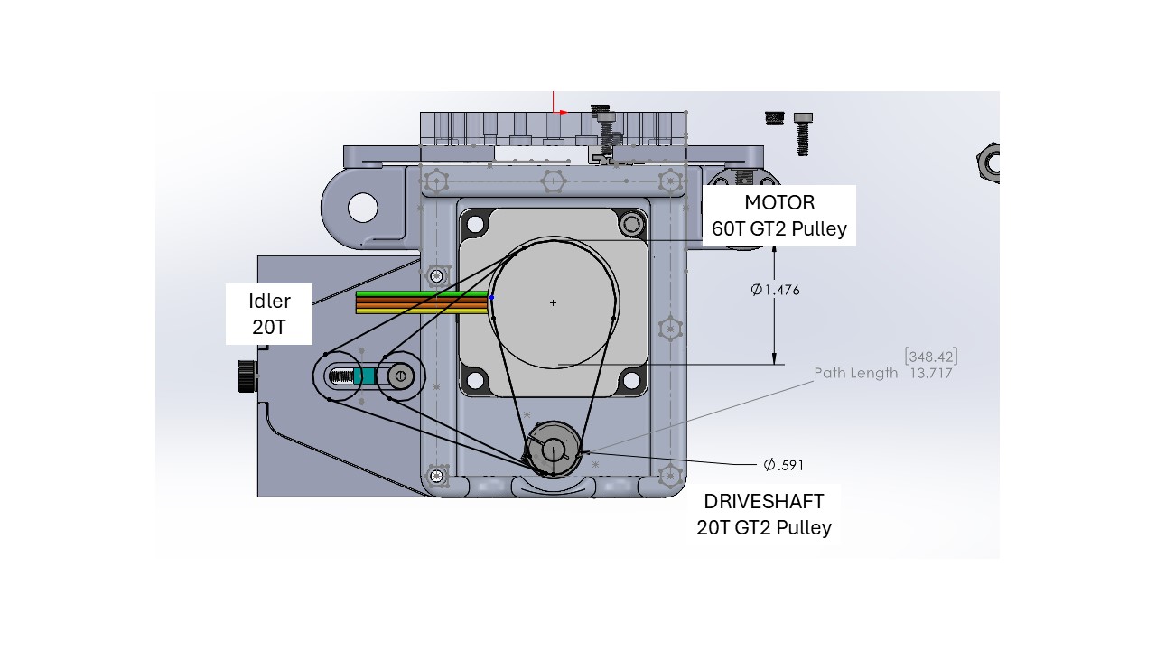

If after you take in to account the mechanical transmission (ball screw, belt ratio, etc.) the math didn't work out cleanly, you wind up with some strange number of input steps per machine unit (inches, mm, degrees). Thats how you get from a drive set to 8x (1600ppr), through a 3:1 belt, and your units are in degrees (1/360)... so you have to tell LCNC to output 13.3333... steps per degree of spindle rotation.
LCNC can't output one third of a step, so whenever you have a non-whole number of steps per unit of measurement, there's a bit of "ish" involved with where the motor lands. LCNC doesn't lose track of where it is, but it can't move the motor exactly where you want.
However... if you program the drive with an input ppr that results in a whole number for each machine unit - degrees in your case - then LCNC can output a number of steps/pulses that can resolve to exactly one degree. For your belt drive, that means 1200ppr at the drive input results in 10 steps per degree - a nice whole number which means LCNC can resolve to 0.1 degrees per step. And 2400ppr gives you 0.05 degree per input step resolution.
Remember a few paragraphs ago when I mentioned keeping the input ppr lower than the encoder resolution? Both 1200 and 2400ppr input values are lower than the 4000 pulse encoder, which means the drive would still have a chance of positioning the motor fairly accurately.
You machine isn't going to actually be 0.05 degree accurate due to variations in the belt, pulleys, friction, lost step here or there... but your INI file will certainly look neater.
